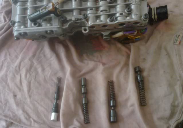

the problem is that, when i opened the upper side cover.
all spring and valve fall out. i can not remember its position.
Can someone take a real picture of those all spring on side cover of
hydraulic Unit. ? Please..

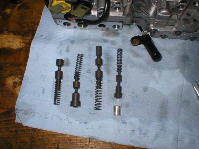

I have brought my spares gearbox out from its hiding-place and its valve block is now sitting on my bench ready for taking apart and photographing.
Sadly, I ran out of time today (much else to be done) and all being well, tomorrow I'll have the necessary information for you.
Posts: 54840
x 8228
Hi Toh,
Here are the spring details:

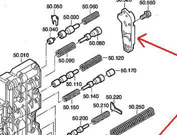

With reference to this diagram:
Spring 50.060 measures 39mm long by 10mm dia.
Spring 50.090 measures 43.5mm long by 10mm dia.
Spring 50.120 measures 51mm long by 10.5mm dia.
Spring 50.150 measures 40mm long by 9mm dia.
Here is a picture of the springs and valves:
Note that Springs 50.060 and 50.150 are nearly the same length but 50.150 is made of thinner wire and has more coils.
I hope that helps sort out the confusion :D

Perfectly done Jim. everything is very clear. :D
compare with my photo,
my longest Spring was put at 50.030. Hahaha. :P
Thank you So much JiM
after re-arrange them all, My gearBox still jerk on every gear changing.
Hm i need to find more what wrong with mine..
