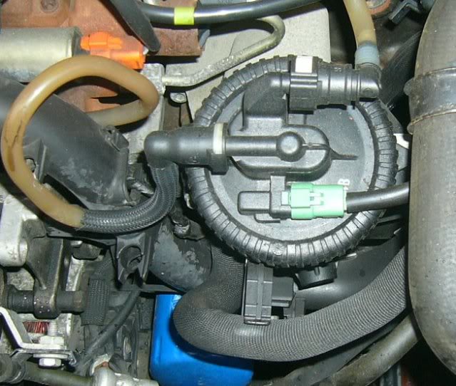

Is it this one?
If so, the outer ring screws off - bit like a Kilner jar.

john alexander
Posts: 360
Joined: 12 Apr 2004, 00:43
Unread post by john alexander »
Nope mine is larger and almost square
