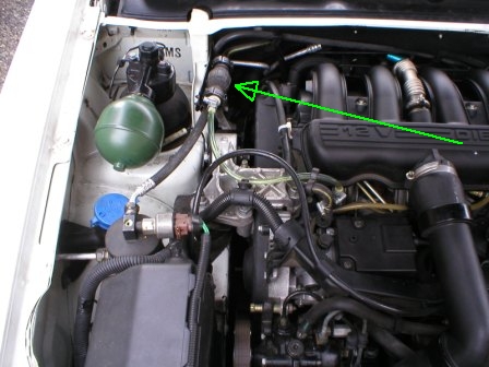

It's the rubber bulge in the fuel line and will be visible under the bonnet. The idea is that if you squeeze it, it acts as a pump and will draw diesel up into the filter and pump.bluemonkey wrote:cheers guys, that was quick replies, silly question what is the primer bulb?
It's designed to prime the system should it run dry of diesel.
The photo below shows one at the end of the green arrow. This is a Xantia 2.1TD engine bay but yours will look similar and be in about the same place.
