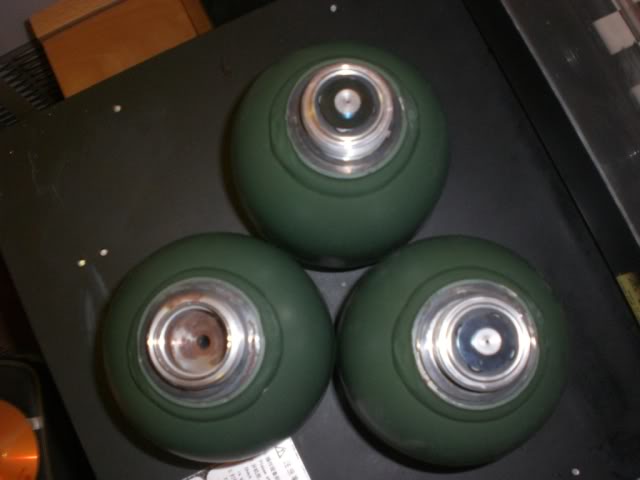

Ok,now heres the real deal. My rear spheres finally gave way, so I went to the auto parts shop and told the guy what I need and for what car. So he gave me three spheres, and because I am a young driver, I decided to have a little fun and change them myself :), but I do need some help. Id like to upload a picture of what kind of spheres I bought, so you can tell me what I'm missing, and what I acctually have. But I see no option here for uploading pictures...
Thanks![/img]
andmcit
Posts: 4299
Joined: 03 Mar 2005, 17:59
x 30
Unread post by andmcit »
The advice for sphere fitting is all covered comprehensively in this thread
I linked to in my last post:
http://www.frenchcarforum.co.uk/forum/v ... hp?t=24595
take heed of warnings for the safe working on the car as these can catch
the unwary with the body rapidly collapsed onto someone working
underneath which combined with high pressured LHM hydraulic circuits
and nitrogen gas in the spheres may cause inadvertent injury.

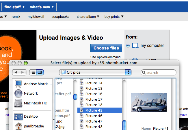

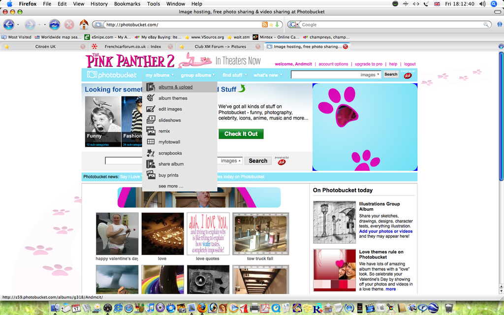

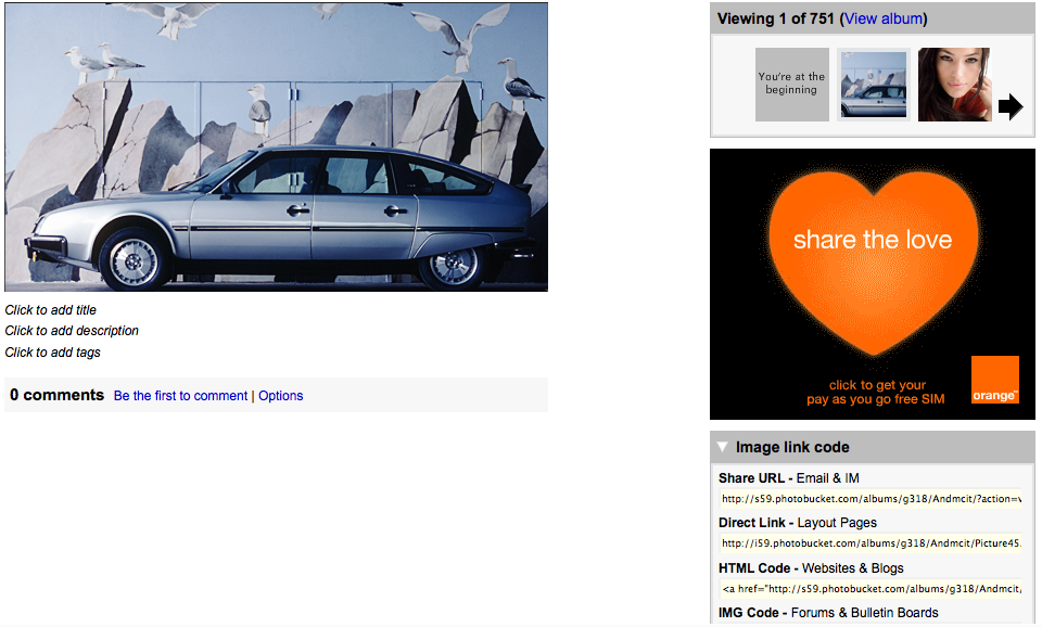

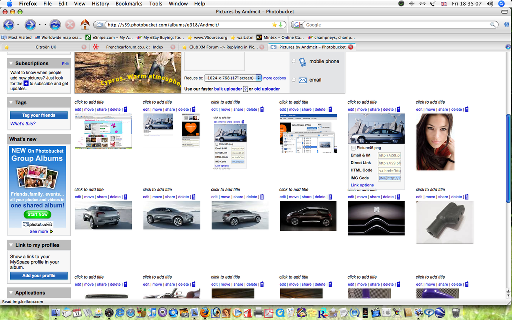

As far as pictures posting onto the forum goes I have a handy set of instructions below:
This starts from the point where it is assumed you have a series of
pictures already on the PC and they're preferably (usually) in a
jpeg format! :D
1: Where you get started - http://www.photobucket.com
Remember too you'll need to create a user name account with a password
to access their system and post images - it's free so nothing to worry about!
The images/video upload:
2: To get a specific picture you click on the "upload" option which will pop
up a search dialogue onto your PC to choose what you want to post:
It then uploads automatically onto photobucket and is catalogued onto your
album for your user account - the album is viewed in two ways:
A - small thumbnail with annoying dropdown options box which plays hard to get:
CLOSEUP:
the code required for a forum picture insert is the highlighted blue WHOLE string such as:
[ IMG]http://i59.photobucket.com/albums/g318/ ... ture24.png[/IMG]
*To get the code to display, I've slipped a barspace after the first [IMG)
B - a larger image filling the screen better which is possible by clicking on the
previously shown above thumbnail:
3: After all that, the code/text can be copied and pasted in the script entry
at the relevant part of your post as you would any posting, giving an end result of:

I'm aware of the dangers, I've looked at a couple of videos on how to change them, but I will ofcourse look at the thread that you posted.
As for the pictures, I'll try it out now :)
This is supposed to be the picture of the three spheres I bought
http://i814.photobucket.com/albums/zz66 ... MG2140.jpg
So if I did it correctly, you'll be able to tell me what I have :)
Thank you!!!
igor253
Posts: 40
Joined: 21 Mar 2010, 12:38
Unread post by igor253 »
Let me try that again :)
andmcit
Posts: 4299
x 30
I'm surprised there's corrosion on the one to the left of the picture
- are these supposed to be new?
This particular sphere is different to the other two in the fact that the throat
where the sphere threads is totally open and doesn't have an inserted 'jet'
that is effectively the damper for the flow of fluid into the sphere and
against the nitrogen gas pocket inside. This particular design is never fitted
to the corners of the car, only in the position of the hydractive centre sphere
at either axle and the main gearbox mounted accumulator/regulator sphere.
This also means the other two which appear to match are corner spheres.
I cannot tell from the picture just by looking at them if they're the exact type
for hydractive mind although this will be a smaller size diameter to non
hydractive! Have you managed to check the feed pipe on your actual car
to confirm which suspension system it uses?
On the second two spheres, are there any stamped figures on the silver disc
where the 'jet' into the sphere is - Citroen as standard practice put the
measurement on this end disc astride the opening as a 0.7, 1.1 etc
measurement.
Additional markings are sometimes stamped on the outer crown of the
sphere just off the "nipple" top which indicate the pressure in "bar"
that's inside from new. If the sphere is an aftermarket one there's a
good possibility of black dot printed serial numbers or even labels on
the sphere to allow specific version recognition - otherwise the spheres
will tend to all look the same at a casual glance.
Andrew

I'm still guessing the car you have to fix is a VSX - assuming that's the case
this article will help - Shane has some very good pictures and in his inimitable
style straight talks through his instructions in an uncomplicated manner!? :lol:
http://www.shanescitshed.com/xantia/xantiaspheres.htm

It's also worth noting, the anti sink sphere whilst threaded onto it's mounting
just like all other spheres has a single vulnerable pipe fed into it's end in a
similar manner to the small 'jet' opening I mention earlier though the joint
has a threaded opening into which the pipe fastening nut is tightened
- this is all shown nicely in Shane's sphiel.
Andrew
