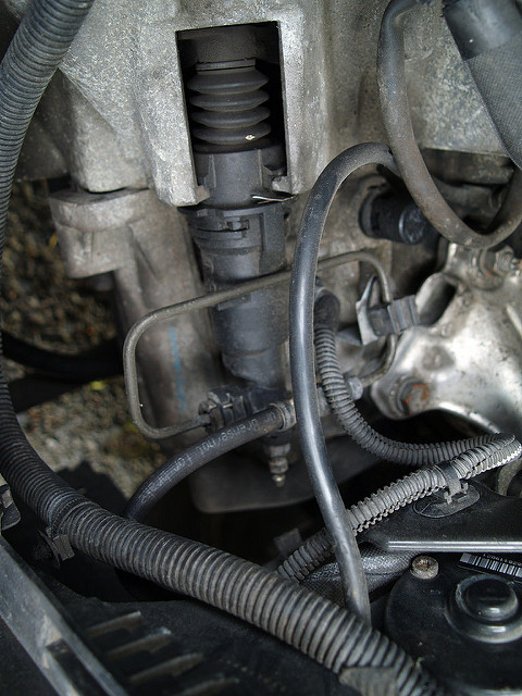

I suspect the reversing light switch, on the top of the gearbox - remove the air filter for access* - which I did then couldn't get the connector off without risking breaking it so put it all back together again. Don't know why as it doesn't work anyway.
Was going to short the contacts out and see if the reversing lights came on. Will do one day too - not today though
Gotta picture somewhere too - if I can find it

Thanks Steve, that sounds fairly easy to get at then. Ill have a look at that, might need a new switch or just a bad/dirty connection.
