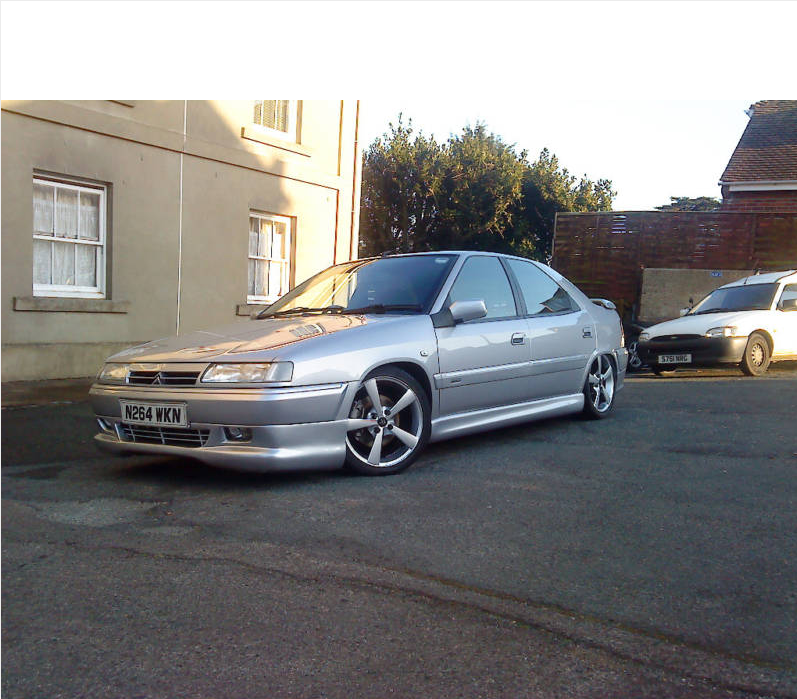

Obviously the offset counts but there's plenty of room above the rear wheel
if you don't get silly with the size of the wheel. Xantiae tend to be better than
other trailing arm Citroens for the longevity of their arm bearings so won't lean
the wheel in at the top of the tyre into the bootside of the wheelarch although
clearance isn't massive and the lip of the outer wing hasn't got miles of space
either.
Dean's silver car shows the space around the sunk down bodywork onto the
wheel as it's on the minimum flat travel and you'll likely be struggling to get
a lolly stick's width of space - I cannot recall the size of the tyres but would
expect 205 50 17's or somesuch as opposed to the standard Activa's tyre
205 60 15's. It's worth checking out the wheel comparison here:
http://www.alloywheels.com/tyrecalc.asp
http://www.kouki.co.uk/utilities/visual ... calculator
Andrew

Just so you know Dave mine on the silver activa are 215/45/17.......im sure but will check in a minute just incase im thinking of the XM. Of course its all down to the offest of the rim in relation to the hub but if you do buy some they usualy tell you what size to go for anyway.
D
D
