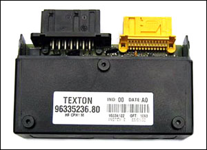

You would also need to swap the CPH unit from the other car as well as the keys. The ECU, CPH & keys are all matched to each other.
I cant remember the exact location of the CPH on the synergie/806 but it's behind the dash, It's a small black box about half the size of the ECU with a yellow and a black plug
This is a pic of one here but a bit of the plastic has been cut away around the plugs.
