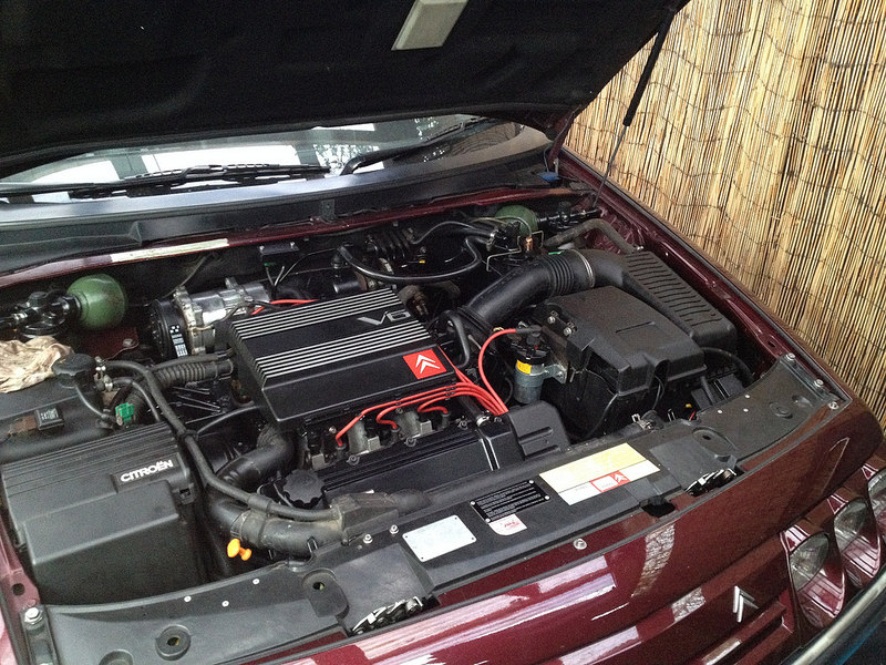

Well,
IMG_3311 by Deanxm, on Flickr
Near success, fitting a set of new plugs solved any remaining running issues (two were totally (-expletive removed-)) and it runs great now.
There is a question mark over the piston liner seals as I'm getting a lot of mayo in the filler cap but then all its done is idle a few times so far which is giving me hope and I have crossed my fingers, toes, arms and legs and will pray I have not made a total poop sandwich of fitting the new ones, that's the potential big issue but like i say it's just been started and idled a dozen times and never driven.
I swore I had a massive coolant leak (hot coolant gushed out all over my hand when investigating) from the transmission oil cooler so i removed it the other night, pressure tested it and it checked out fine so have re-fitted it, while muttering and swearing of course and wondering if I was mad but after tonight's activities have noticed a couple of drips of coolant hanging on the gearbox again so im confused about that although it could just be some remaining coolant from the great gushing, maybe, possibly.
The engine won't turn the cooling fans on so have to turn the A/C on to keep it cool, they worked before so the problem must be a simple to fix one I'm sure.
But apart from all that, it's looking and sounding very good, and is mobile!

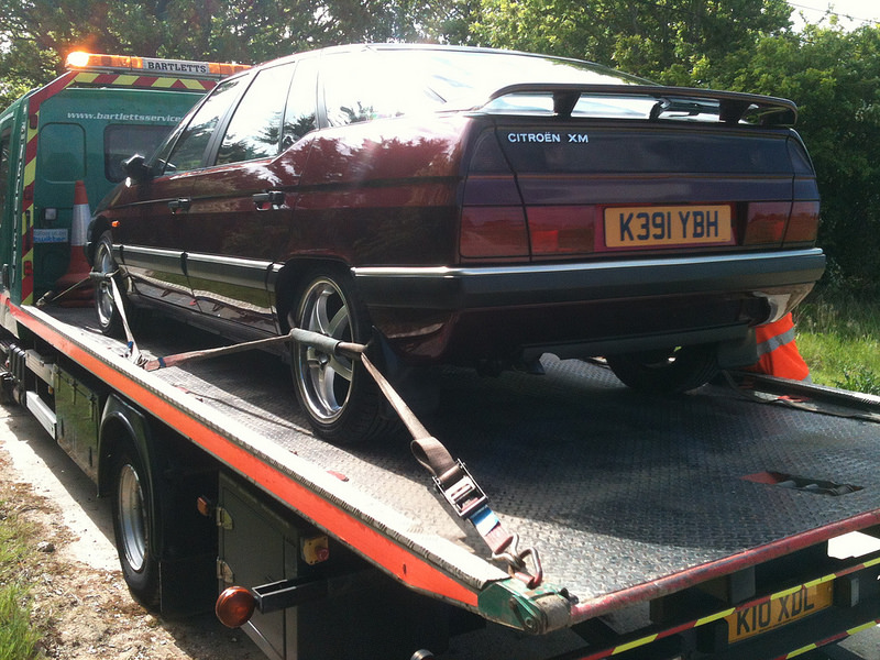

Well the car did go out and the mayo vanished straight away, a failed ignition module and no spare resulted in a ride home on the back of a lorry!

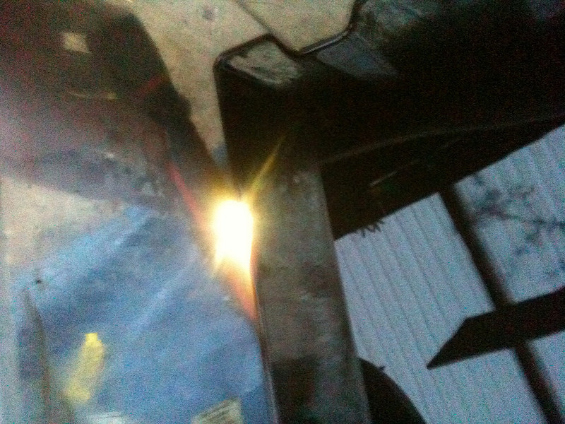

The culprit was not only a section of the loom to the module but rather obviously the module itself too

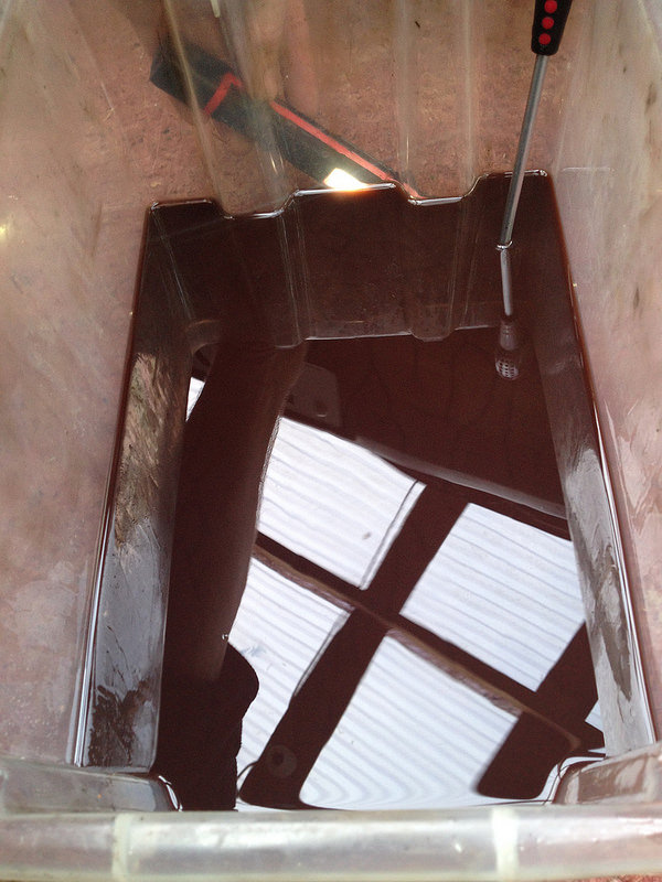

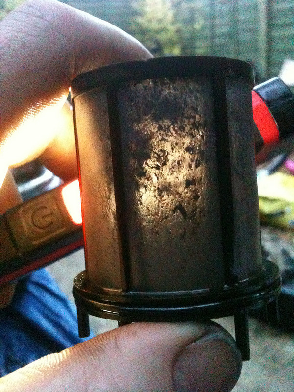

After MTXM kindly sourced a replacement for me and a little more driving it was time to change the fluids and this was my 50mile old gear oil and filter, i think the depths of the box were hiding much gunge
photo(15) by Deanxm, on Flickr
photo(9) by Deanxm, on Flickr
Another 50 miles and another change produced this, at least it has a pink tinge to it rather than bog black!

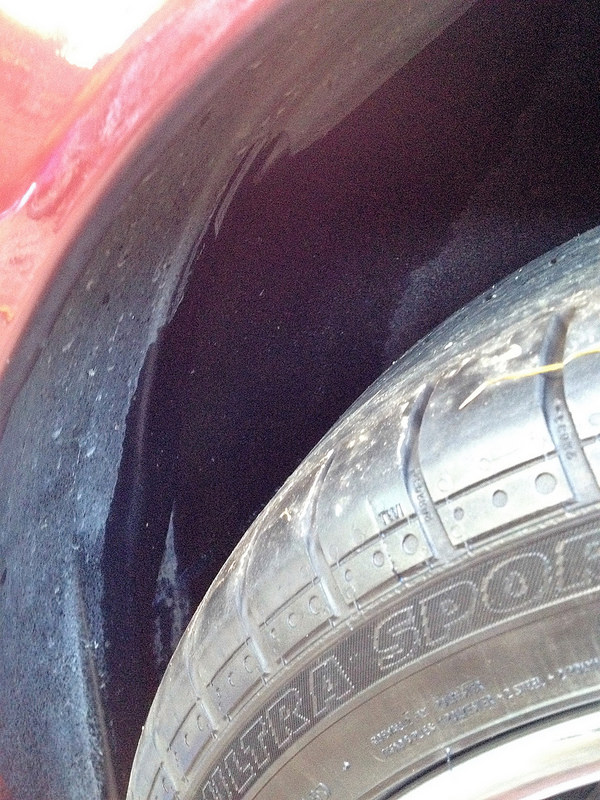

Of course the brake valve seal decided after 25 years this was the time it would choose to roll over
