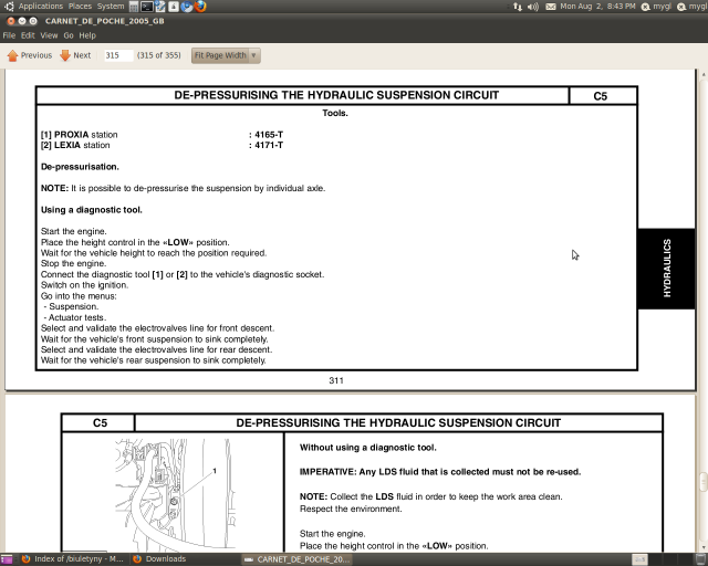

how do you depresurise/represurise C5 suspension, as i have got to do bearing on both rear arm's

Have a gander atthis Malcolm, particularly the pdf.

but i cant find the section for depresurising/re/presuring the hydraulic circuit,
regards malcolm
Posts: 28716
x 5672
It is on Page 311 of the pdf Malcolm.

well i got under that C5 today and depresurised useing the method without the DIS LEXIA,
with the rear end up on axle stands i let the suspension down after running the engine, then pressing the down switch on the centre consoul,
then pleced a jack under the disc hub across to the calliper so i could lift the arm up to compress the suspension cylinder/s,
on attempting to undo the calliper bolts they undid with great dificulty, as they have corrosion grown between the bolts and the calliper/s,
i have removed the N/S calliper but the bolts are still firmly stuck which i will work on tomorow,
regards malcolm
