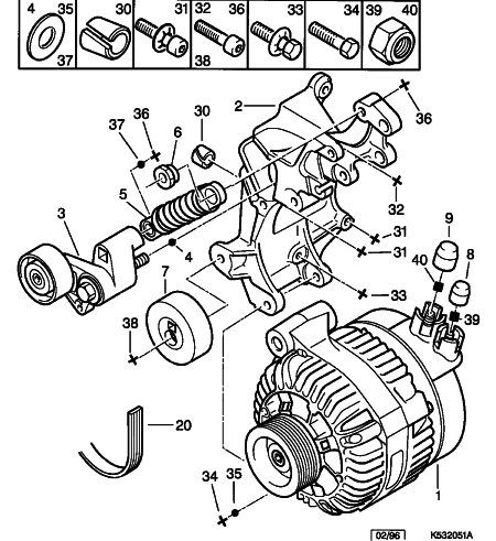

This is the diagram I belive. Items 3 and 5...
I cannot at this time verify part numbers...
It works hard and if of inferior quality or if incorrectly fitted then that's what might have occurred.
It's worth checking the spring part is good too as if that's worn it can cause the tensioner to move around excessively, thus shortening its life.

The diagram above is different to my xantia the top of the spring bolts directly to my hydraulic pump and the big bracket No 2 is missing on my car.
at least somebody recognised it, this set up seems to differ from my original setup which was a fixed bracket before the car went into citroen for tensioner pulley replacement.
they did install the spring at the same time but it looks like they removed the fixed bracket
this setup does differ to earlier xantias where the shock absorbsion is taken up by the tensioner itself in conjunction with the top of the spring being bolted to a rigid bracket. it seems that they fitted something from a later model. my setup has the top of the spring bolted to the hydraulic pump which is mobile the hydraulic pump moves with the pulley assembly tensioned by the spring bolted to the hydraulic pump, I think this must put more strain on the bearing that pases through the engine block.

From your description Nigel, yours was wrongly assembled and possibly bodged at an earlier date. The spring should be firmly attached to the pump cradle and not the pump it self. That diagram is right for your car and if yours does not follow it, your car is wrong.
I've seen the spring replaced by a length of solid metal bar before now
Get whoever does the job again to assemble it properly. Likely some original bits are now missing and a visit to a breakers may be needed to get the necessary.
As yours is a MK2, it will have the same arrangement as the 2.1TD. Early models of the 1.9TD had a different arrangement and the two are not interchangeable easily so don't go comparing with your dad's car! I hope someone in the past has not tried to make up some kind of hybrid in an attempt to bodge it.
At least you know why it's all a bit short-lived now and that I guess is good. Rebuild it properly and your troubles should be at an end.

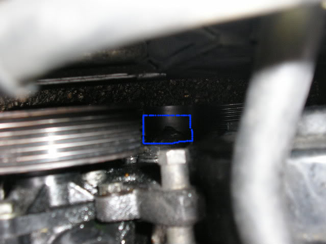

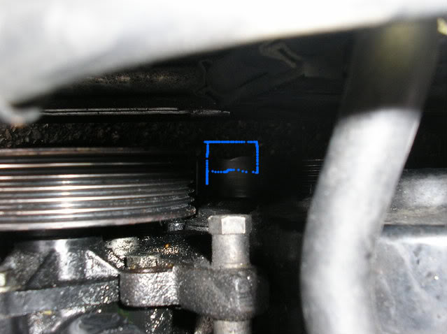

On much closer inspection I do appear to have a very close fitting bracket which does give the illusion that the spring is bolted to the pump at the top end.
as you said dont compare it to my Dads Mk1 which is exactly what I was doing. the bracket is much more prominant on the Mk1 and more hidden on the Mk2.
so Now we have a bracket it seems it may have been assembled right by Citroen after all
I think it would be better to ask Martin @ Pleiades to fit a new tensioner assembly and have the old one out completely. what annoys me most is at times of emergency and ltd funds Citroen wont fit parts a customer has purchased themselves because they say they dont use auto-factors but if you spend enough time in the parts department you'll see and hear phonecalls to auto-factors and see the vans pull up on the forcourt. cheeky beggars.

thank you for the diagram I can print that off and show Martin at least I can be fairly confident that he will use good parts and not some rubbish that doesnt last very long. he did the cambelt, waterpump and serpentine belt back in February this year. wee couldnt find the cause of this noise even when we put the car back up on the ramps, martin retentioned the serpentine belt pulley bolts in the hope that the noise might go away, it was just out of luck that I put my hand on the spring and it went silent with no more rumbling noises about a week ago.

Paid a visit to pleiades this afternoon just waiting for a quote now Martin stripped down an old Bracket and showed me the needle bearings inside.
