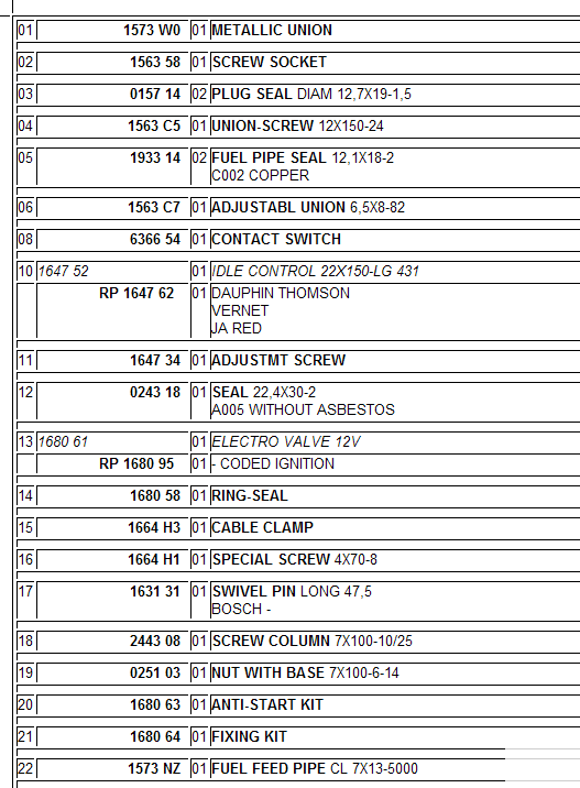

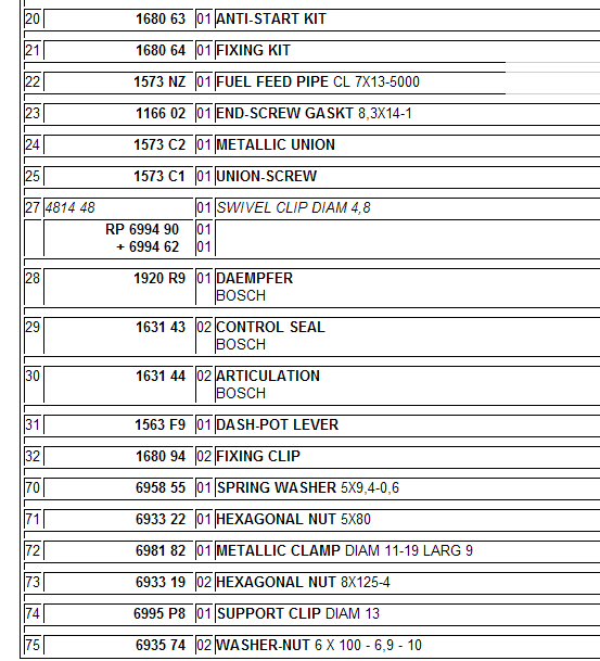

i belive this is price and part No. for what you are after Nigel,
from service citroen,
Part Number Description Quantity Price excl. VAT Price incl. VAT Total incl. VAT Selection
0000193314 FUEL PIPE SEAL 0.45 GBP 0.53 GBP 0.53 GBP
and here is the banjo bolt cough cough give me some oxygen
00001563C5 UNION-SCREW 20.98 GBP 24.65 GBP 24.65 GBP
regards malcolm

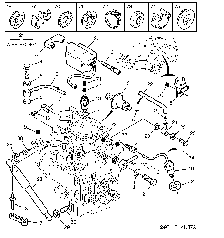

Just to add a bit more :) , I know its a Peugeot diagram but still, a picture speaks a 1000 words as they say:
Andy.
