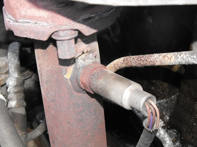

The exaust is leaking around the oxygen sensor mounting, you can see the soot, this can cause fueling problems, there is no point in looking for a running fault until that is sealed. Try sealing it with some exaust putty for the time being to see if it helps your problem & take it from there. Did any of the wiring of the oxygen sensor get damaged when the exhaust dropped ?
d3xt0r
- Posts: 41
- Joined: 25 May 2010, 16:40
thanks for pointing that out mate, ill get it sealed for now or could i weld it, if so what weld should i use as i know some metals are harder to weld but inevitably im going to have to replace the exhuast manifold bit but that can wait i suppose.
The wires are all fine.
Thanks for your help
