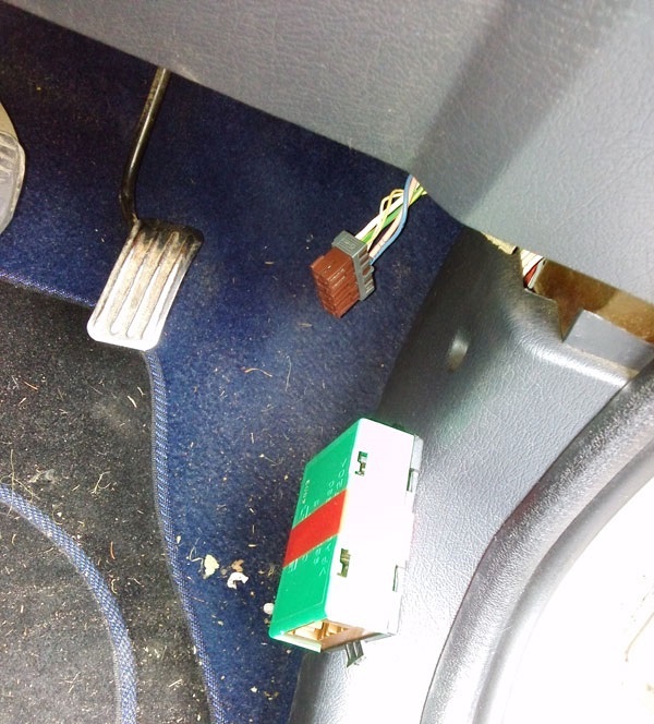

The Green Auto Switch Relay Box to which the dash button wires lead is just under the felt under the fuse box in the drivers foot well.
You should hear a click from the little relays inside the Green Box as you press the dash window button up and down.
If you do, then possibly a Motor issue as the switch 5A circuit works fine.
If no click, and bare in mind the drivers switch had a lit LED, then most probably the fault is within the Green Box or it's connections.

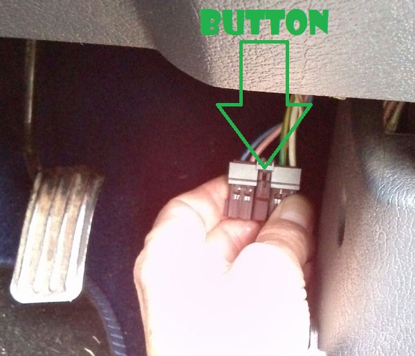

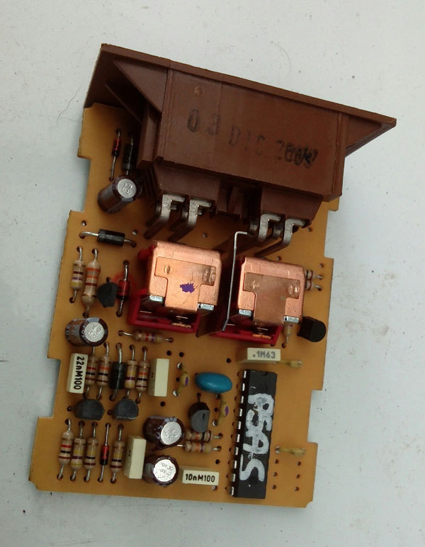

This Green Box is easy to split. Once separated the electronics and both up and down relays are accessible. This is why the Drivers window has two fuses. A 5A circuit from the switch to Auto box relay and a 20A from Auto box relay to Motor.
The usual Torx screws hold it in place. The wiring connector gets in the way of the second screw and as I wasn't sure how to disconnect and in a hurry, I broke it off
However, it is easy to disconnect by just pressing the middle "button".

As I no longer trust the part and want my window shut when leaving the vehicle, I've relocated the part for access. (rotate to connect).

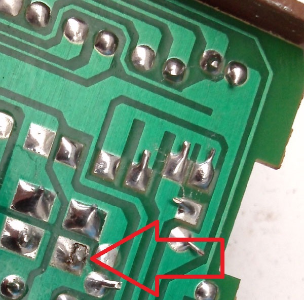

This time I got a magnifying glass and checked the components and solder joints.
Indeed, a dry looking joint on the 20A circuit. I think it's the delay to release power once the window hits rock bottom as the relay still sends power for around half a second to a none turning motor. Just a thought.
Any how, soldered and job done, for now!

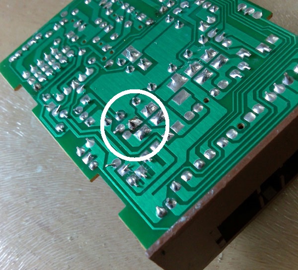

very nice thread mate......resolved an intermittant fault I had on my drivers window....Had a different dry joint to yours on one of the legs from the connector block...bit of cleaning and a spot of new solder, all working fine now...

Excellent info - Had several dry joints
Resoldered joints and now all working

Hie what is the voltage of the capacitors i broke and lost mine

I guess that 25v working would suffice, but don't know the value (?F) of that electrolytic capacitor.
PSA don't normally publish any details of the contents of individual electronic modules - just the surrounding circuitry - but someone here with a similar vehicle may be able (if you were very lucky) to open theirs up to read off the value of those two capacitors. Alternatively, try trawling the web for 'repair' articles on the module.
