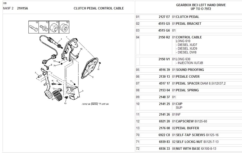

As this is almost a Partner too, I wonder if these share the 'assistance' spring they fitted to later 306's :?:
It lists two for LHD Partner vans:
BE3 LHD UP TO 0 7972
BE3 LHD SINCE 0 7973
Pics of a LHD Partner van: (although I do not see any immediate difference)

That's the assistance spring, it actually looks more or less the same as a 306 one from memory.
That's there to help you get over the fulcrum point (if that's the right phrase?) where the spring 'helps' to lighten loading.
What's the cable end at the transmission like ? , its almost certainly self-adjusting but the ratchet adjuster in the cable might be failing hence this happening.
You can pull the release arm on some and have it move back to see if the cable adjuster is ok.
Andy.
