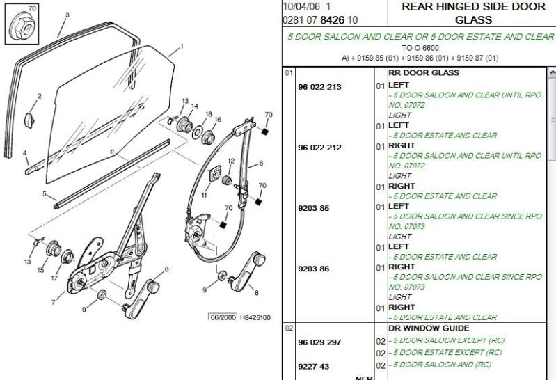

If it's anything like the front door glass, there's a plastic clip to hold it in place.
I've had the door trim off my ZX a few times now - it's not too bad.

The cable that raises and lowers the glass will have snapped. Probably due to water getting past the window seal on the door and running down the cable and causing it to rust. Solution is a new winder from a scrappy if you can find one in better shape. If you do make sure that you cover the cable in as much waterproof grease as you can. Haynes describes the job pretty well if my memory serves. The only difficult part is removing the door lining without breaking the plastic lugs or ripping them from the hardboard lining and getting the clip that holds the glass onto the mechanism. It helps if you can get the one from the scrappy out yourself as you learn how it all comes apart on someone else's car! And keep whatever clip arrangement comes with the new winder as it may not match your existing one.
