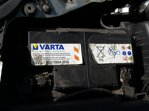

Expect in the region of £80~90 for a decent one - I will check mine as I'm sure it is the original and see what the rating is - diesels need more oomph than petrols as they need to run the glowplugs as well as crank a cold engine so buying a cheapo could be a poor decision.
Varta Batteries
Exide Batteries for C5 Diesel
I can't make any sense of the Varta designations - at least none tally precisely with mine. The nearest seems to be the silver - E38.
Best price I van see is here:
http://www.dcbatteries.com/userimages/V ... 61740).htm *
£83 + £7 carriage.
*That URL will not resolve as it is, you need to copy and paste it into a blank tab then scroll down to the "VARTA SILVER DYNAMIC E38 (100)"
Varta Batteries
£83 + £7 carriage.

Very true, best to have the battery tested by someone who has a clue before spending money unnecessarily.dnsey wrote:Just to be claer, if you're sure that it was a fauty ECU, the battery may well be OK. My suggestion was that low battery voltage may have been upsetting ECU operation, but it's unlikely to have damaged it.

C5s do have pretty heafty batterys as the suspension pump works when the car is not running.
I think they are about £90ish for a decent one, usually.
