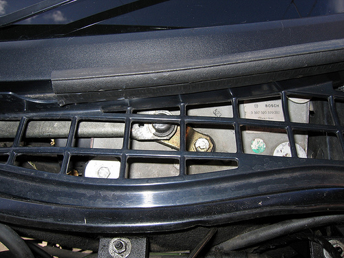

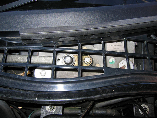

Thirdly, my wipers begin the upstroke before parking. It's only a cm or two but it bugs me. Is it "normal" or is something amiss alignment wise? Also, where can I get a rear wiper blade from that doesn't cost silly money? Universal types don't fully contact the hatch rear screen nor do they have the correct fitment.

The wiper issue is common and sortable but you need to remove the scuttle panel to do it. Once off, adjust the arm on the wiper motor to lie exactly level with the wipers parked. You'll likely see it a few degrees off level. Level it and it'll park perfectly! Pierre, when he built the mechanism must have been lazy!!!

The problem is down to the crank arm being at the wrong angle as below;MikeT wrote:Thirdly, my wipers begin the upstroke before parking. It's only a cm or two but it bugs me. Is it "normal" or is something amiss alignment wise?
Rather like this;

Thanks for wiper arm pics - I won't be scuttle removing though so if it can be done otherwise, please give instructions or is it a matter of just working through the gaps? I take it the short crank arm needs to come off and move a spline or two to make it horizontal?

Simply poke a socket on an extension through the scuttle, undo the nut then reposition the crank arm.MikeT wrote:Thanks for wiper arm pics - I won't be scuttle removing though so if it can be done otherwise, please give instructions or is it a matter of just working through the gaps? I take it the short crank arm needs to come off and move a spline or two to make it horizontal?

I would say it sounds simple enough but best not to tempt fate with my track record.DickieG wrote: Simply poke a socket on an extension through the scuttle, undo the nut then reposition the crank arm.

Thanks Malcolm, that's the sort of tips I need reminding about. I would probably have fully removed the nut and promptly dropped it into an unreachable recess.
