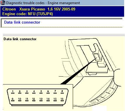

Hi, i've just bought a 1999 xsara westcoast 1.4 petrol and was wondering what diagnostic cable i need. i have lots of software for diagnostics etc but dont know which cable i need.
cheers
d3xt0r
EDIT found an image of it

i think this socket is called EOBD

thing is its not actually shaped like that its more like a rectangle so ive ordered an ELM327, said i could return it if it wasnt the correct tool.

sounds like you must have the one like early XANT's and this one is called a 30 pin conecter

Thats the right socket, xsaras only ever came with the 16 pin socket. It might appear rectangular but it may have little lugs at the edges so only that type of connector will fit it.

Yes wheeler, it is a 16 pin that is a similar shape to the image above. i managed to get the ELM327 kit hooked up but it was a tight fit due to a lump on 1 side were there was no gap on the kit but got connected anyway eventually except i get an ECU error.
This is the furthest i got, other software wouldnt even recognise the device.
I dont know why it wont connect to the ECU :?
