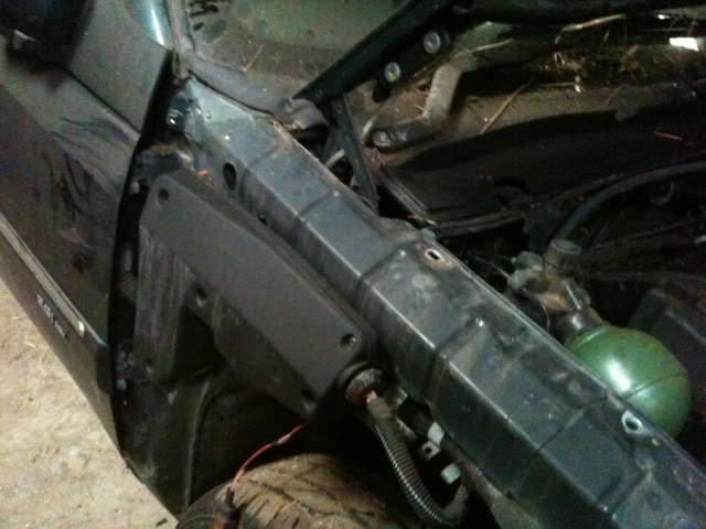

It's got me stumped! It lives behind the driver's side wing on a
1998 2.0i 16v Estate with auto adaptive I'm currently breaking.
There's just electrical feeds - no pipes, seems reasonably heavy
and has a series of small torx holding the two halves together.
I can't disconnect it so will likely leave it on the shell or open it
up/cut the wiring feed. Not decided! :?

Any clues or suggestionson this piece? I thought initially it must be
cruise control being an auto car but there's no dash switch. No traffic
master either!

That'll be the flux capacitor Andrew :lol: :lol:
Now, seriously, let me know of any wire numbers on the loom going to it and I should be able to work out what it is...

In there you'll find relay's, in a S1 it houses the headlamp wash relay and a couple of other's. I spent quite a lot of time searching for the headlamp wash relay on what is now Jim's Activa, I can't believe I didn't look there first :lol:
Just undo the Torx screws and all will be revealed, it won't go bang!
