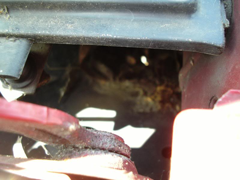

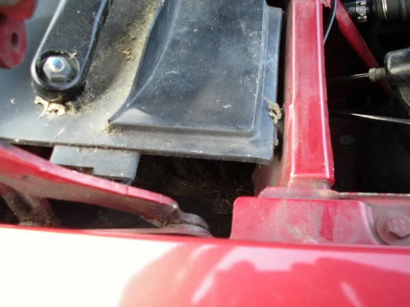

On both sides, you can get at it via the holes in the scuttle trim. Nothing needs to be disassembled.
Carefully extract all debris. If dry you can use a Hoover with a small nozzle.
Look down and you'll see small grilles in the bottoms of the sumps at each end of the bulkhead trough that holds the wiper gear. Water in the trough proper will run into one sump or another, depending on how the car is leaning.
Finally, tip a jug of coloured water into each sump and ensure it immediately runs away and exits into the wheelarch. The grilles are just above the arch liners...
ICO1 is in the offside sump, covered by a plastic cover on the floor of the sump. This plastic cover has the grille in one end that acts as the sump drain.
have a good look and study and all will become clear

I took a gander today and clearly saw the N/S grill was pretty much clear but on the O/S, there's just a solid scuttle and a very small gap to peer into
Unfortunately, I couldn't see how/where water might enter the cabin but the drain hole is obviously there for a reason.
On reflection, I should have done the water test first but didn't fancy adding to footwell contents so set about clearing leaves as best I could. It looks fairly clear now and a water test shows it flows out the designed hole into the wheel arch area.
Hopefully, that's solved the problem.

Scuttle only lets water into the car via the Blower motor, which is on the Passenger side..
Theres a black cover down there Mike on the drivers side, that covers the Main loom from inside the car to the engine bay, that passes that corner and goes through the inner wing behind the outer wing and down to the front.. there is a drain hole along the edge of the black cover though, but like you, cant see this letting water in..
Is this the S2 car?? Then we can assume no sunroof.. A main door seal prehaps?? Front door etc???
