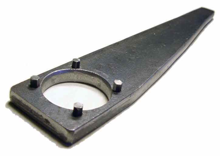

Not sure if I posted this before, but you can make up a tool for the ball pin outer using 10mm steel plate and bits of allen key cut up with an angle grinder.
The large hole needs to be a close fit over the rubber boot to keep enough metal for the pins. The diameter of the small holes should be about half way between the AF of the hex and the across corners of the allen key. Start with the bits of allen key long, and grind a taper. Press them through with a strong vise, then grind off the excess.
In use, always fully remove the locking peening, then fit the tool using suitable spacers so that you can securely nip it up with the ball pin nut. The tool must be clamped so that there is no slack, or it will cam out. Then hammer round the tool to unscrew the ball pin outer.
The tool shown has removed quite a few without problem. It can also fit the new part, but you need the proverbial scaffolding pipe or similar, and ideally a similar length of heavy angle iron fixed by a couple of wheel nuts to hold the strut steady. Controlled tightening is better than hammering it round. Indeed, the correct torque can be applied using a spring balance at a known radius.
This method can often be used to make up strong pin spanners, and avoids the problem with a home made one piece tool of correct heat treatment.
