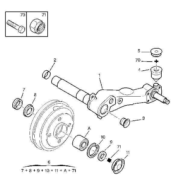

I think I found it, this is a Pug number though:
I should point out that pic is for a pre-facelift (pre 97) 306, but a ZX is the same car anyway :)
The 'big washer' is part number: 3736 29
For reference:
Item 11 : The soft 'cover' (if it had one)
Item 71 : The actual hub nut (pic is not quite right, look at top left to see 'real' image)
Item 9 : The actual washer (373629)
The items beyond that are the bearing assembly (you can see they are grouped anyway)
Ask your part dealer to look under > Restyling (body NOT mechanical!) > Suspension / Engine / Electricity > Leaf Springs Rear > ;)
Andy.
