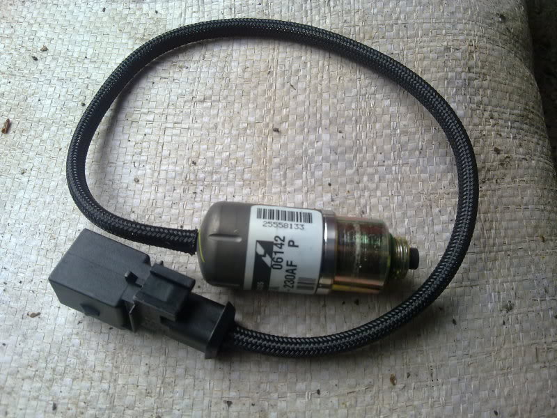

Yeah the pump module/soleniod are the same unit so you cant just run an ignition live feed to it like with the old bosch ones, you would need to fit a totaly different solenoid. I have one of the solenoid modules, i'll look it out & post up a pic later.

Heres what the lucas pump module off the DW8 looks like.

That looks fairly simple to bypass.
just cut off the electronics box and find the live wire that energizes the solenoid.
Or am i missing something.
Thanks for the great pic and comments

ok thanks wheeler i have not had any dealings with this type as yet,
rizlas wrote
"That looks fairly simple to bypass.
just cut off the electronics box and find the live wire that energizes the solenoid."
the electricary will be in the solenoid head, inside that metal dome, it might be possible to cut the dome off and bypass, dont know if anyone has tried this yet Jim/wheeler??????
