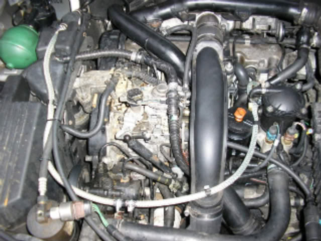

I have had to replace the fuel lines on my old 1.9td and now my 3.2td and i managed to get the clear line from Hyphose.
Not 100% sure of the internal diameter just now but it is braided hose and costs the extortionate price of 77p a metre
All i did was take the lid off the fuel filter housing and got them them to get me the correct size pipe.The pipe will fit snug on the filter lid outlet,a tad loose on the fuel pump/primer bulb connection and will need a little bit of hot water treatment to get it to fit over the fuel filter inlet.
The reason for using the braided hose is that it has the rigidity built into it to stop it folding in on itself.
Not sure if this will be clear to see but it is used in the following pic
As per previous answers an air leak/ingress will cause no end of problems starting the car.Have you checked/replaced the leak off pipes recently
