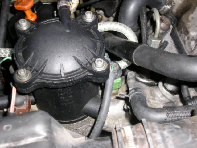

Hi Kenny,
The engine coolant temperature sender and the dash gauge sender are individual parts - Green = dash gauge, Brown = Bitron and Blue = ECT.
I've just been out for a quick looksee and I'm 99.9% sure it's the sender itself as with it disconnected, the Lexia shows a constant -45 (In hindsight, I should have checked to see if it logged a fault code too
) and with my multimeter hooked up to the sender, it read correctly until it got warm/hot then all hell broke loose - readings all over the shop, hence my certainty the sender is fubar'd.

The dash gauge sensor (blue) has no part in engine management. It is purely for the driver's information.
If your Bosch pump has full timing control (as mine does), the green (rear) sensor is the one to check.
To test any of them; Connect a multimeter to the sensor pins, set the scale to resistance and run the engine. As the coolant warms, the resistance changes (drops I think). Check the change for smooth progression.
Mine starts off normal but goes haywire after a while.
