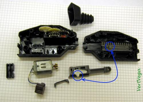

Hi Paul, I just replied in other thread about this. We were typing at the same time
I have opened it simply by using "brutal force" after I got the replacement part and made sure that it's working.
It's heat (ultrasonic I guess) welded and here's a pic showing parts in it:
It is not meant to be opened or in order words it is very challenging to put two covers together.
