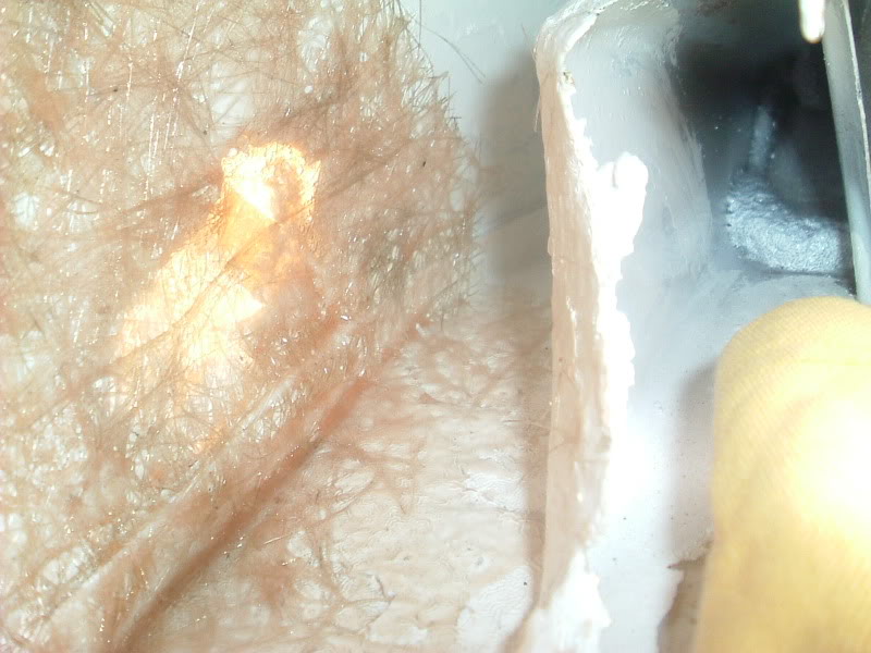

Hi all, I have found another place where water is getting into my Xantia. :roll: Air vents in the boot.
There are water tracks as you can see in the pictures, but I have no idea how it is getting there. The sun roof drains are all good, as are the light clusters.
I have removed the vents to expose the area for inspection. In the second picture you can see some foam at the top of the vent, this is wet.
It is the same on the other side. I have sat in the boot when a mate covered the car with a hose pipe, but nothing. It is only a dribble, but enough to pool in the boot over night when it is raining.
Any ideas where this is coming from?

Posts: 55087
x 8391
Sadly Martin, being this was the only dry part of my Activa Project, I have little experience of these vents.
If the foam at the top was damp then the rogue water is coming from above the vent and not through the vent.
If you pull the foam out, what's above it?
Does it communicate with the foam that is wrapped around the rear seat belt spool at all?
If it does, this is in contact with the hole in the top of the wing where the sunroof drain pipe exists. If the pipe is loose in this hole, running during wet weather can cause water to splash back up around the sunroof drain pipe and be absorbed by the foam. A bit of sealant around the hole to seal the pipe in will do the job.

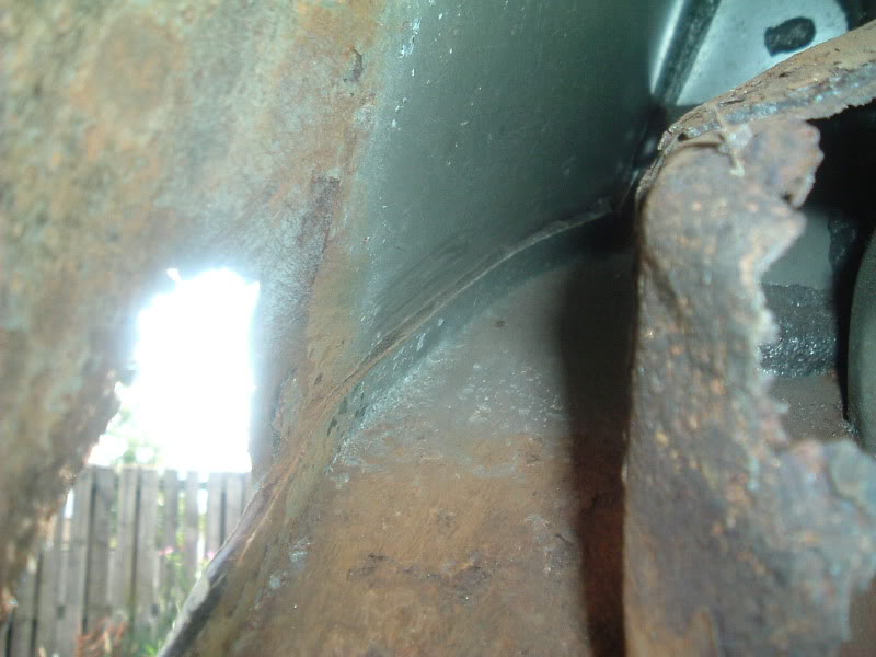

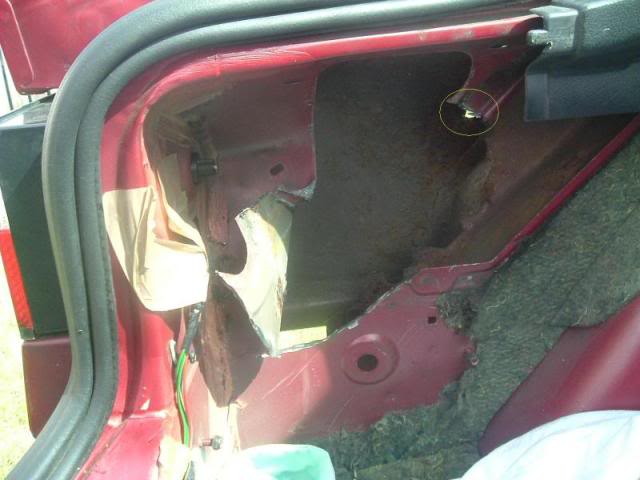

I have the same,but much worse!!
I'm 75% sure it's coming from under the car!,ie,spray,from the rear wheels. I had a perfect spray pattern of rust inside the n/s rear quarter,it actually rotted through,yellow circle. I fiberglassed and filled and primered it tempererily:

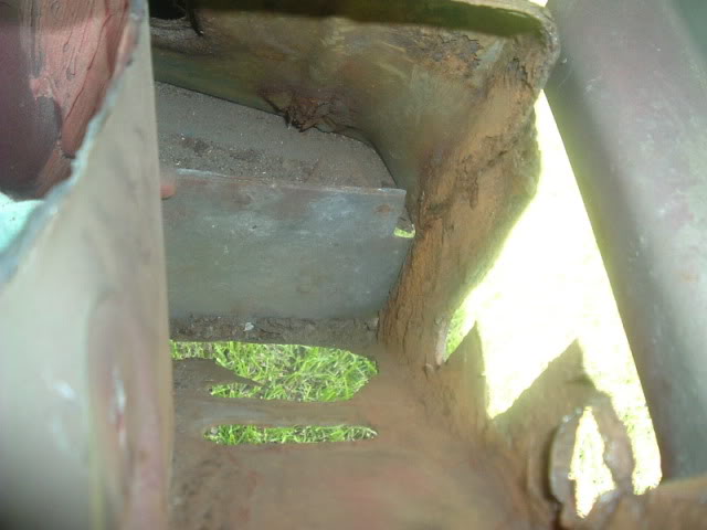

I bodged/blocked these holes off months ago in the winter,(looking down the inside of the wing),so i can explore more soon:
sorry if the pics are mahoosive and ruin the page!

Bloody hell Dave, that is worse than mine...
I was thinking it could be spray off the wheels getting up there too. I shoved a hose pipe up there and nothing to be seen coming through.
Having said that my N/S is worse and looks like water has been getting in there for some time. There is a square hole at the rear of the arch that water could get into, but not sure if that would get up to cause a problem in the vents location. Should that hole have a plastic plug in it?

I asked that very same question on here,as i also had the open square hole..thought some of the liner was missing...blocked it off.
N/S is closer to the curb and away from the centre cambre, = more water :wink: i've heard this many times now.
My cars previous owner worked 'darn sarf', lol, so regularly spent hours on the motorway at,ahem,70,in the rain.
So my logic is: big holes/vents + 70mph turbo jetwashing rear wheels = the perfect rust spray pattern i've ended up with..The panel is fine in front and behind,just nakt in this centre arc.
Like i say,gonna sort it properly soon,had to mothball it for the winter. Only started because i noticed a paint blister on the rear quarter! so it's rotted from the inside out? Shouldn't it be galvanized/protected? maybe a pattern replacement quarter after a bump...who knows.
Anyway,call me daft but as above, water + holes = rust!
