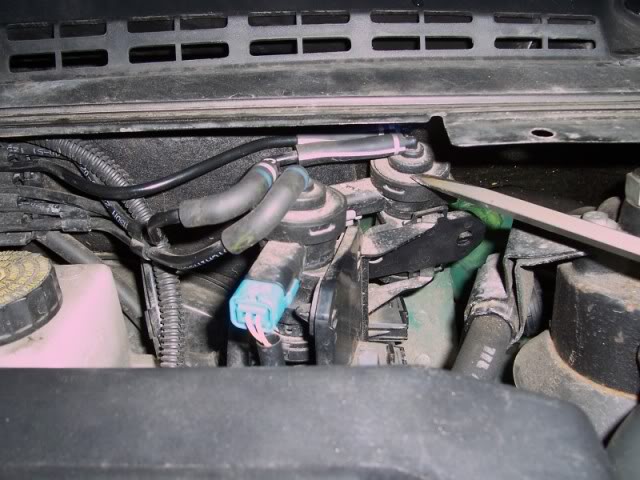

hello again. just got home with new turbo solenoid control, uncovered the side you said only to find there are three solenoids there all look the same, the only difference seems to be the electrical connectors are three different colours. pls can you tell me which one it is i am replacing.

update, well i fitted a new turbo vacuum solenoid and went for a drive.
disappointment rained down when after the usual ten minutes the warning lights came on and car went into limp mode as before. think i will have to look into the vacuum diaphragm. thought it would be too easy to just be the solenoid. i think this will continue later.

That's bad luck.
But, If it's not the vacuum solenoid itself then maybe it's a problem with the wiring to the solenoid because, in your original post you said that the Lexia reports 'turbo circuit short/open'.
This sounds like a wiring problem (if not the solenoid itself).
I think that if the vacuum diaphragm were split you'd get an overboost reported and I wouldn't have thought that the Lexia would have said anything about the turbo circuit.

In the failed swirl valve scenario the vacuum for control of both the turbo and swirl valve is common a loss of vac in one is a loss of vacuum in both. With no vacuum for control the turbo will overboosts. The ECU picks this up because the actual Turbo Boost is outside of the map. Further because overboost is a potentially engine damaging condition it goes one stage further and restricts the engine operating range such that engine damage will not occur so called LIMP mode.
The Lexia will obviously report the overboost error.
I am not surprised that changing the EV has not resolved the problem EV failure is not common.
As I said early before changing bits you need to identify where exactly the problems lies. the O/P has done the right thing initialy in getting an ECU read out now it is only a question of a few basic checks. All that is required is a vacuum gage some odd lengths of suitable sized plastic pipe and some plastic T piece joiners, the latter can be got from B&Q and Vac guages can be purchased at most good autosuppliers but it does'nt have to anything special I use an old aircraft altimeter an old aircraft boost gauge or (the best one ) an aircon vac gage depends which I find first in the rubbish tip know as the garage.
However there is a check that you can do even without the gauge. The swirl valve control Electro Valve is on the side of the engine adjacent to the swirl valves. You will need to remove the rubber inlet pipe from the mass flow housing and you will then be able to see the swirl valve EV. Take the pipe of the top of the EV complete with rubber sleeve this is the vac supply to the valve now find a piece of plastic dowel or metal rod even a bolt of size which you can use too insert into the rubber sleeve, the idea being to seal it completely. Replace inlet duct and go and drive the car, you might find it less than lively at the bottom end but if the turbo is now working correctly you wil not get the messages and the car will not go into LIMP mode.
cachaciero

Fix it in your mind Kev no vacuum no workyKevMayer wrote:That's bad luck.
These cars run on diesel and vacuum.
If the turbo overboosts the only message you will get in the car is the standard AntiPollution message and the engine will go into LIMP mode. The Lexia will be able to read the stored error code which will have recorded the turbo overboost and that is what it will say.
The lexia has no way of knowing that there is no vacuum because strangely given it's importance there is no vacuum sensor to feed data to the ECU.
