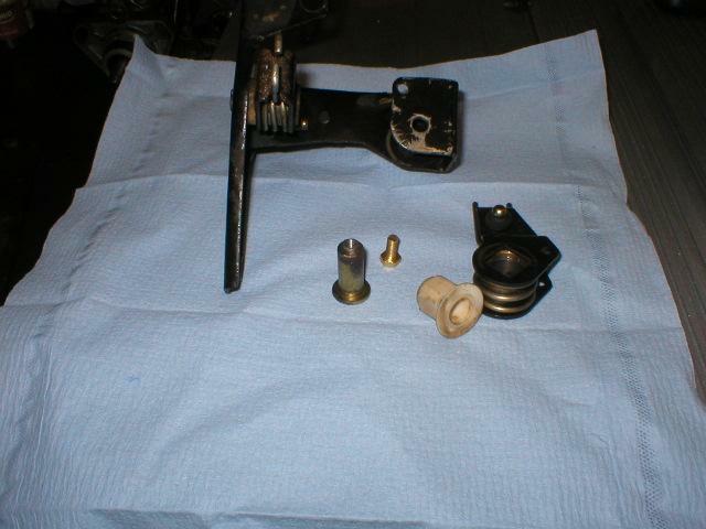

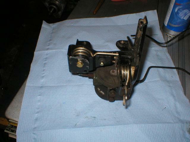

Also, a very worn "dog-bone" (the white plastic link between the mechanism and the anti-roll bar) can cause jerkiness, as can a loose ball on the mechanism itself if its rivet comes loose. The ball can be seen in the pictures below.
Here are some pictures of the mechanism dismantled and together. Note that the bolt to allow full disassembly is my modification as the pivot is normally riveted and they're not easy to dismantle.
