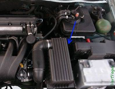

In mine, there are two wires coming off the negative terminal.
One large-diameter wire goes from the battery negative terminal to the gear box.
The second wire goes to the "chassis ground hub" (don't know the official name)
as seen in pic below:
Gear box connection point can be seen looking down from the gap,
as marked in the pic:
Chassis - Gear box (and engine) together makes up the "common earth".
Doors, hood and tailgate are also connected to this common ground with wires.

Thanks for the reply,
I've checked these ones and given them a good clean.
I am interested in the earthing points for the instrument panel. Are they part of this cluster.
