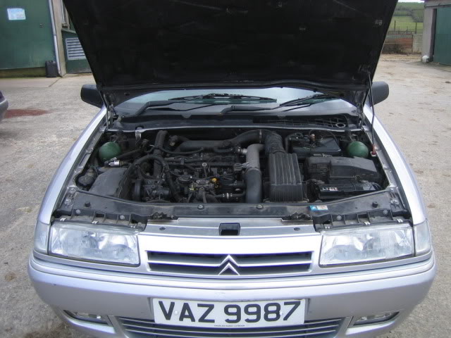

I've just picked up an Activa yesterday.
Its a 1997 Model with 108K on the clock. First impressions are good, the Anti-Roll system works and is very impressive to drive, and its a nice change to be driving a Turbo Petrol Xantia rather than a Turbo Diesel.
It has the usual Activa faults, leaking ram return pipes, clonking from the rear ram bush, and a nice little slow shuffle dance from side to side at idle as well.
I'll take my time at working through these problems, and get it MOTd again sometime soon. So I'l be asking plenty of questions later on.
Its not a bad car on the surface, some marks and dings to be expected with the age, but it will clean up well. The interior is nice, no wear to the seats or fag burns, again a deep clean will do it no harm either.
Here are some pics for your viewing pleasure.

Nice tidy car.
