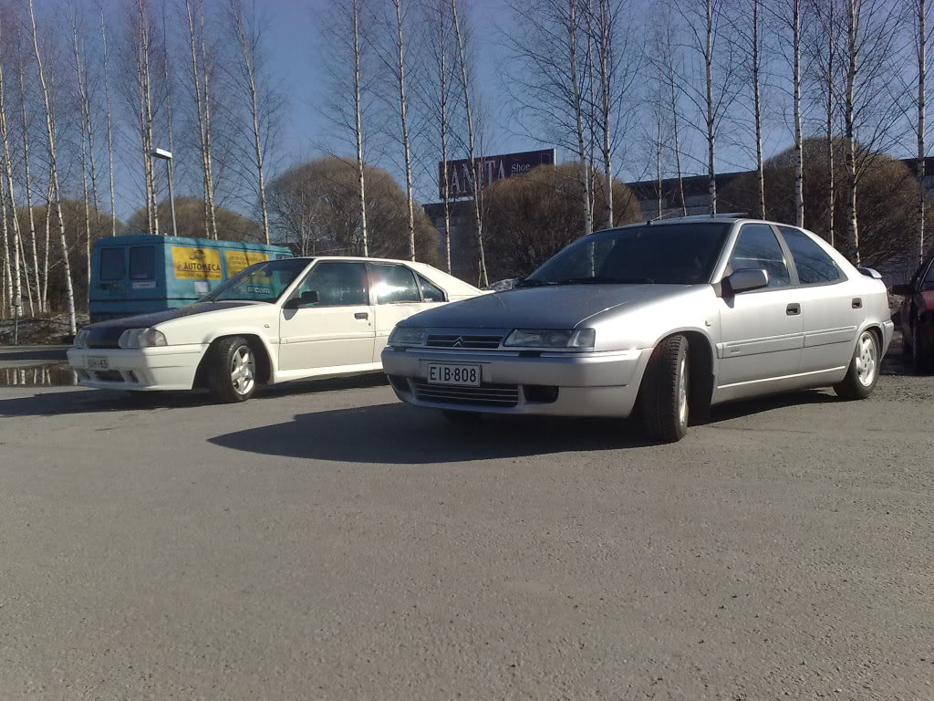

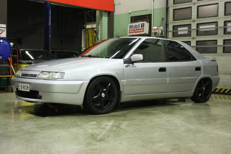

Ookay, so story begins about a year ago, when i got a urgent need to have Activa, i found one for 1750€, went to look at it, minor glitches here and there, red interior lights (plus some blue neons) :P, some coolant leak and ofcourse all spheres gone bad.
400km drive home went well except i had to add coolant once in a while.

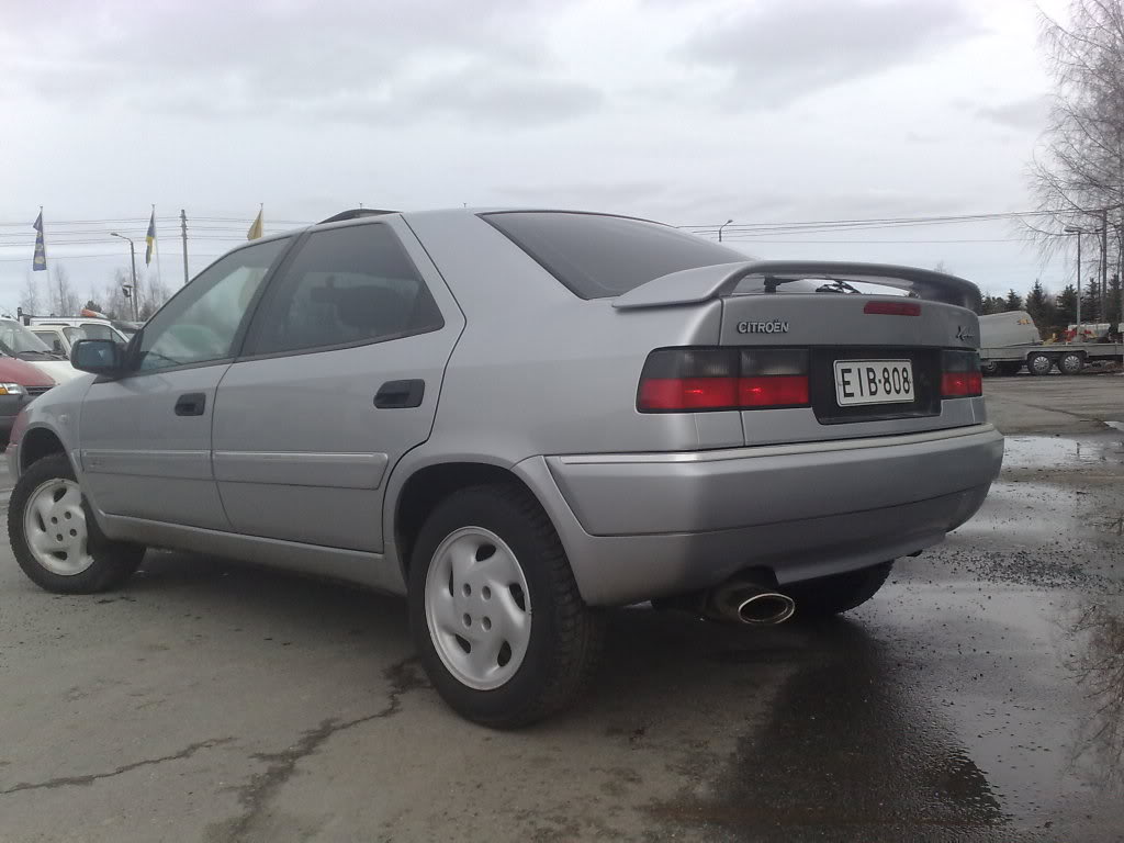

Here's a pic from next day of purchase:
Time went while a was in the army, nothing really happened then, girlfriend just drove it without problems.
Here's a pic of both my cars i had then:

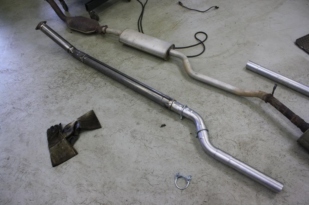

Friend of mine made new exhaust system for me while i was fixing hydraulic leak

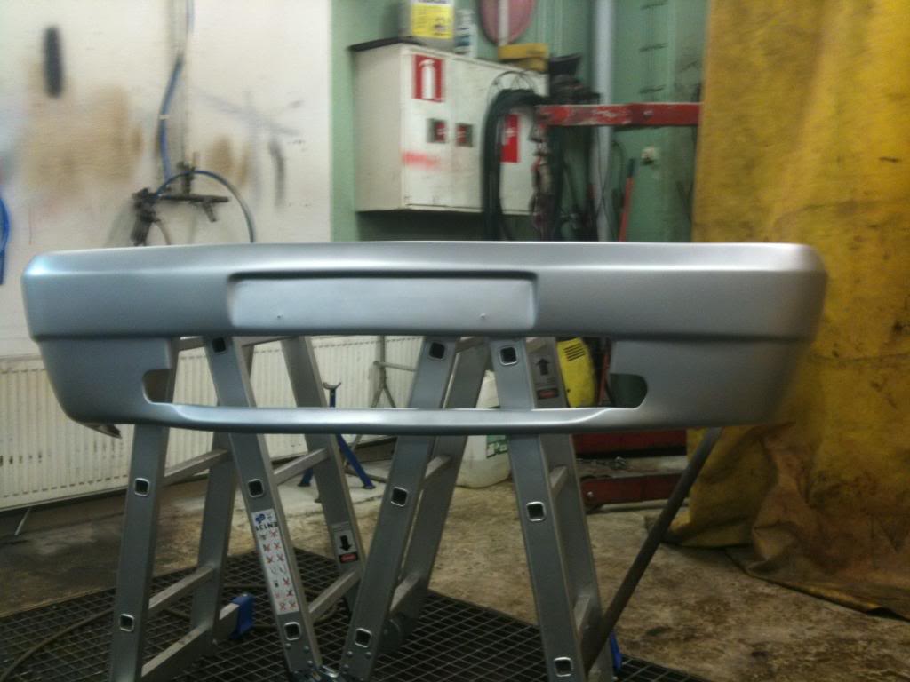

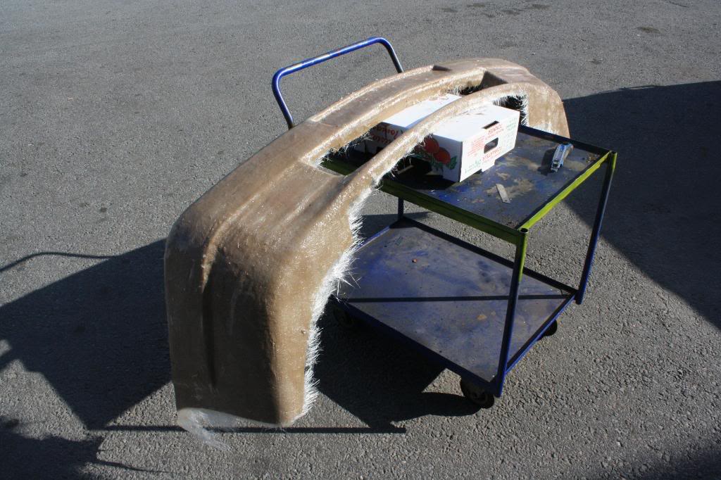

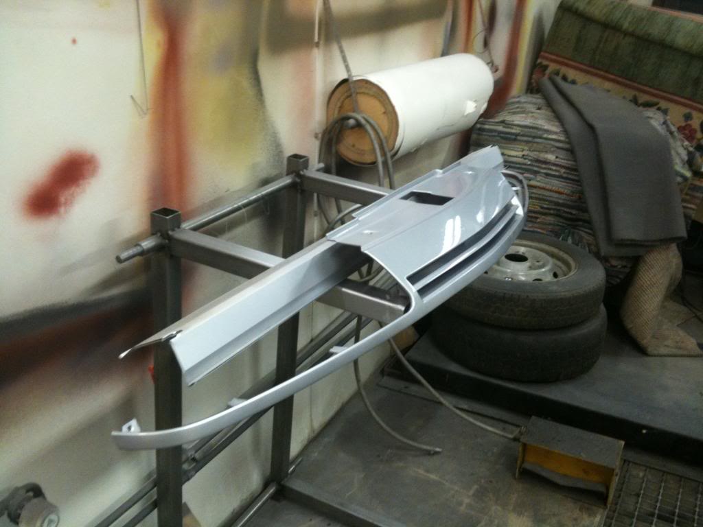

Another friend of mine came to look at my front bumper and then we tought to make some modifications for it.
We start at making a fiberglass copy of it:
Exhaust done and new 17" rims installed

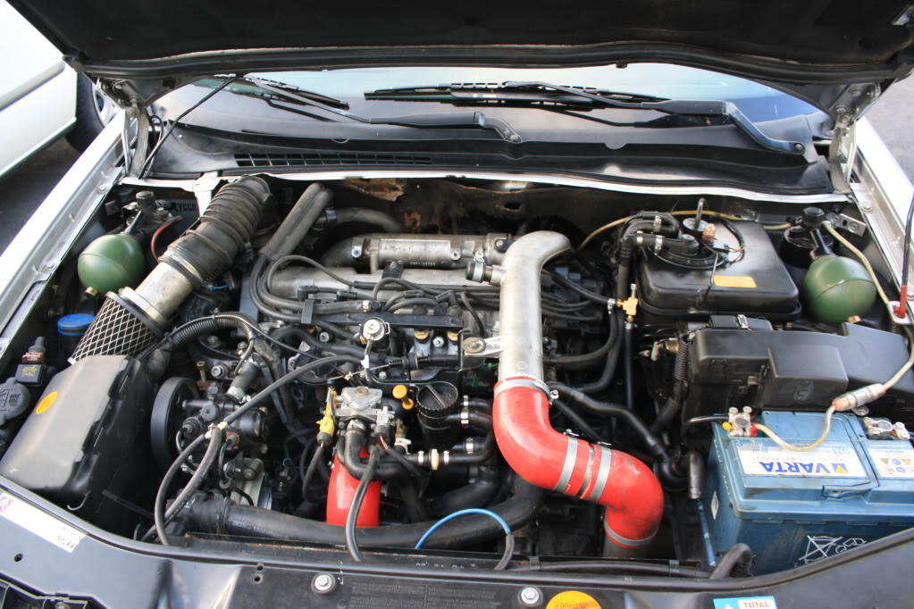

Here's a pic of engine bay:

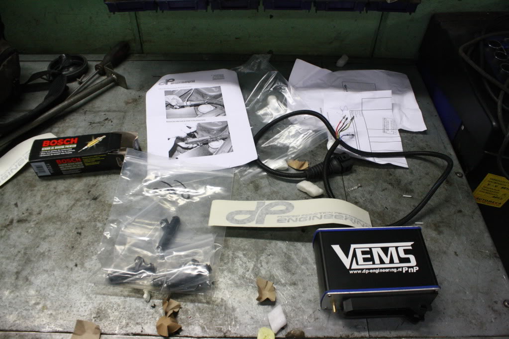

And then finally, package arrived! (after a looooong wait)
Quick install and start the tuning:

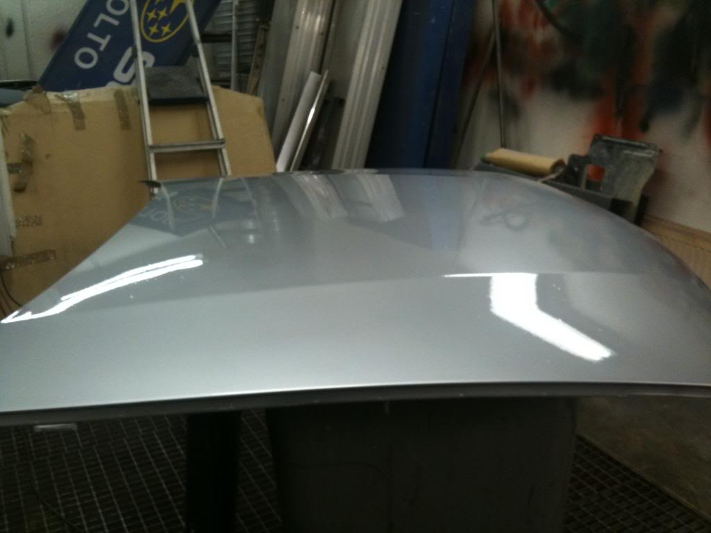

Pic of paint ready bumper and grill:
Painted hood, bumper and grill:

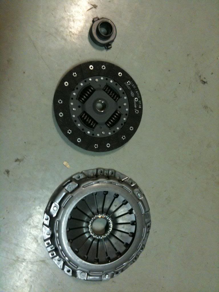

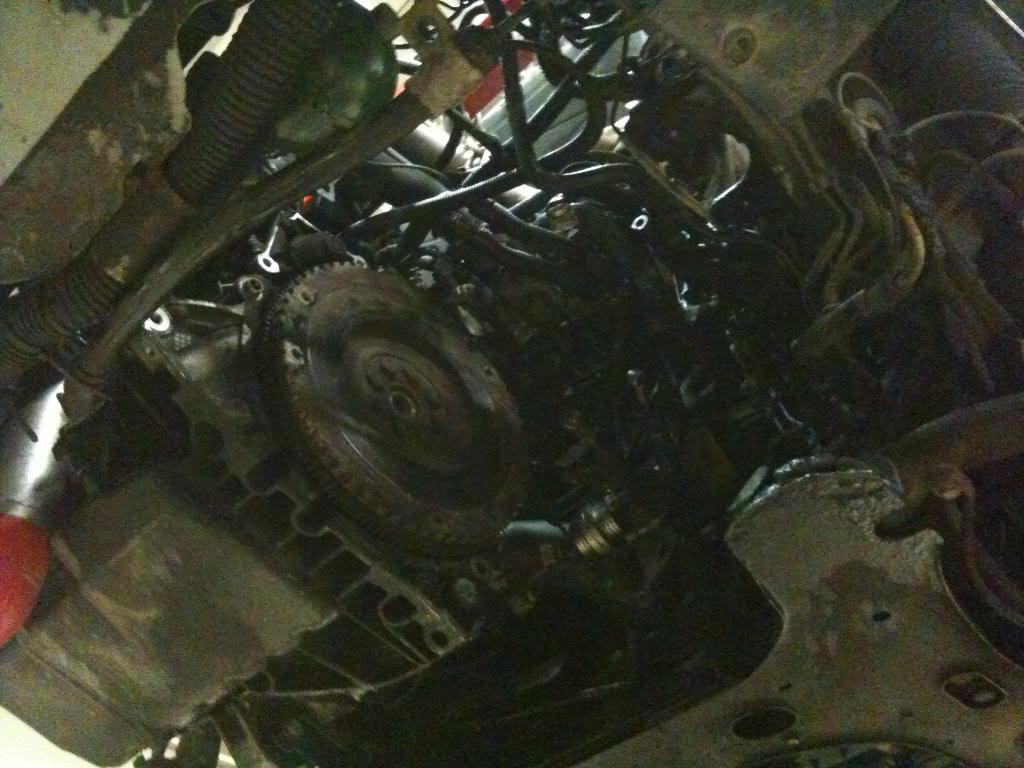

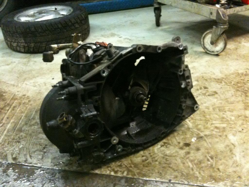

Now that it was working quite good, ofcourse clutch started slipping! (it's 300000km droven so...)

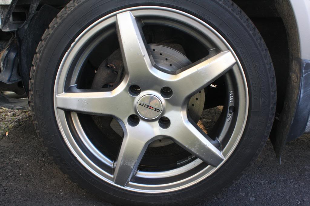

Now i traded my original Activa rims for 17" Mille Miglia Spyder with 225/45-17 winter tires

No bad English at all Jeth :D Better English than some English speak :lol: :lol: :lol:
Excellent Pictures :D That was a great job on the intercooler and new bumper to fit it! Certainly better than my Finnish!

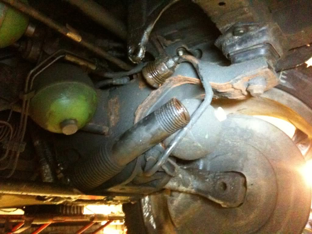

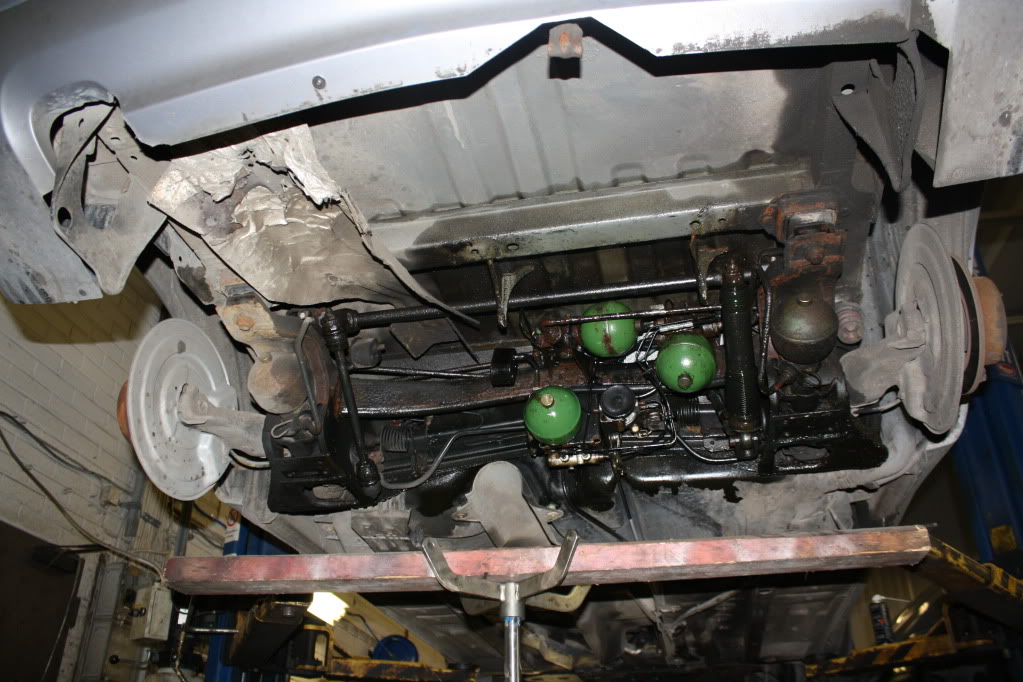

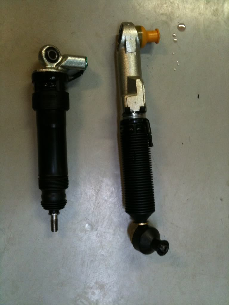

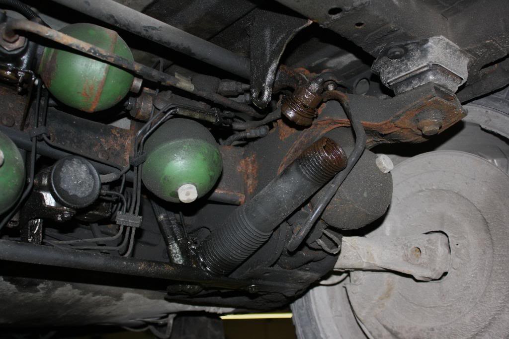

I have never seen a rear ram broken like that :twisted: What happened? It looks like the top balljoint has come adrift. Can you/have you repaired it as I expect just as in the UK, new rams in Finland are very expensive :twisted:
Lol thanks.
I really don't know what happened to that rear arm, it just suddenly started to feel as comfortable as other citroens :P
New ram 500€
Im gonna get a new one, but right now I can't afford it, so im driving non-activa activa :D

About the same cost as in the UK then :(
Jeth wrote: I really don't know what happened to that rear arm, it just suddenly started to feel as comfortable as other citroens :P
LOL :lol: That is funny Jeth!
Without the ram in place, there is almost no Anti Roll Bar on the rear except for the very thin cross bar that operates the height corrector although the front ram will still be doing some anti-roll work. I guess the car is rolling rather well now?
Don't go around corners too fast!
I shall be very interested to learn how the ram failed....

I would do something about the air filter and its location. Its too small, its foam (poor filtration compared to paper and even cotton filter media) and will suffer pretty bad from heat soak, plus it looks to have no cold feed to it at all. Just sorting out that issue alone will give 5-6bhp, maybe more!

XantiaMan wrote:I would do something about the air filter and its location. Its too small, its foam (poor filtration compared to paper and even cotton filter media) and will suffer pretty bad from heat soak, plus it looks to have no cold feed to it at all. Just sorting out that issue alone will give 5-6bhp, maybe more!
Like I didn't know ;) I've just been lazy lately..

Jeth wrote: Now i traded my original Activa rims for 17" Mille Miglia Spyder with 225/45-17 winter tires
Those Mille Miglias look very familiar... did your Activa rims go to a dark coloured V6 Activa in southern Finland? :)
- Previously Activated -
Jeth
Posts: 63
Joined: 02 Feb 2010, 16:28
x 1
Unread post by Jeth »
Yep they did ;)

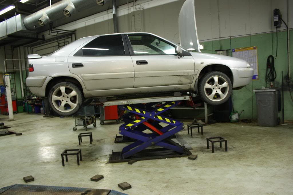

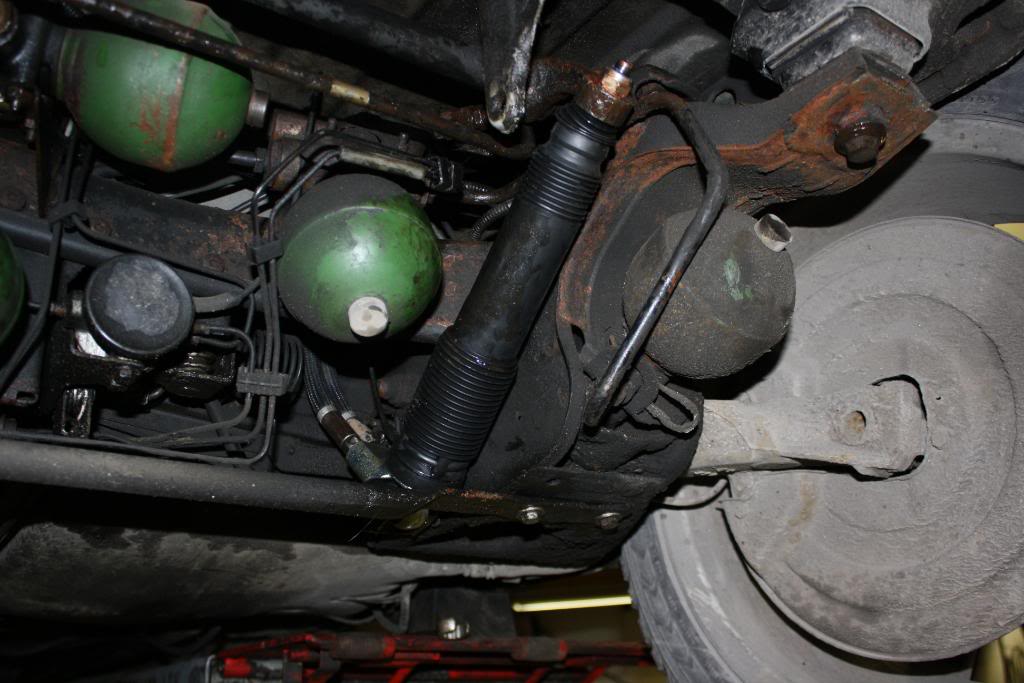

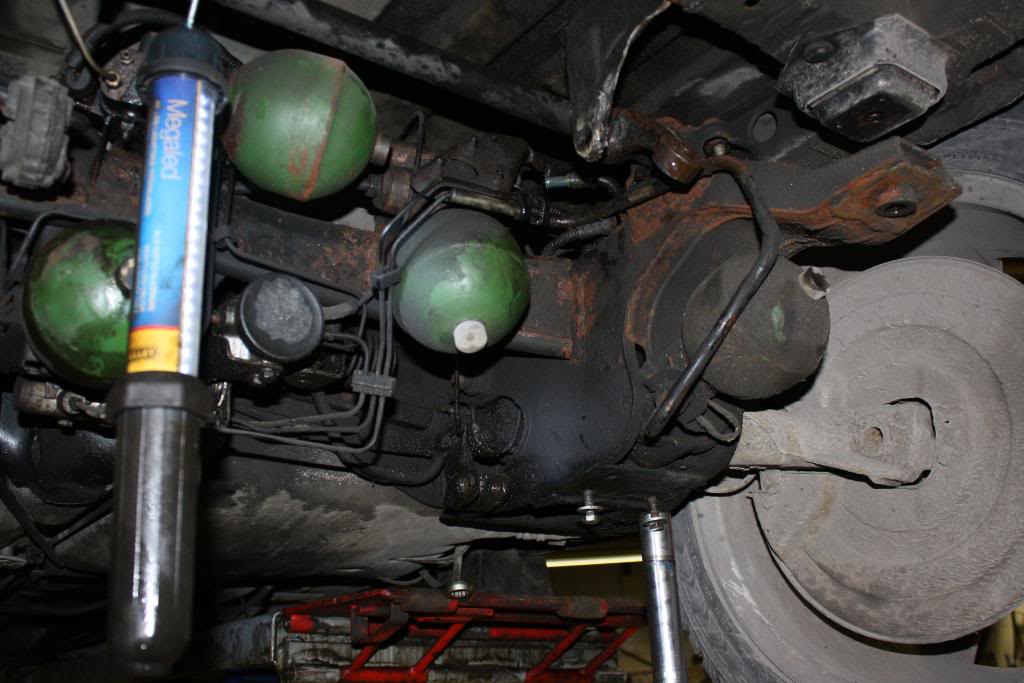

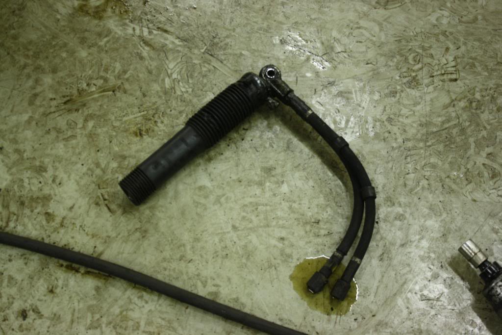

Ookay, did something today..
Here it all began:
Old one off:
New one in:
Summer tires/rims on and a quick wash:
