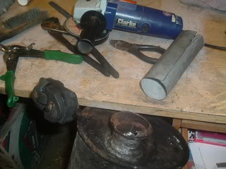

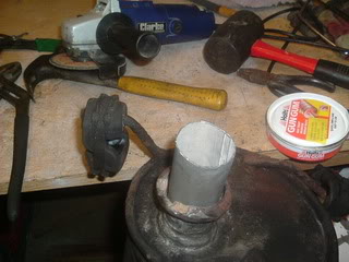

I have to agree with this fellow,and old guy above. I have exactly the same symptoms. and, my exhaust pipe has just completely snapped off at the rear box,leaving the pipe resting on a bar/brace? that is bolted to each side of the car.HDI wrote:Just to give an idea of how much an exhaust can leak without it being detectable until the windows or sunroof are opened , the exhaust on mine has completely broken away at the rear silencer box connection and there is no smell of fumes until a window or the sunroof is opened !!
You will have an exhaust leak somewhere.
Open the windows and monoxide city lol.
Mine's been badly stick welded (burnt the flange away), so a lot of bodging for me will be needed.
I'm thinking of putting a metal sleeve\tube inside the back box and the pipe,bit of paste,maybe a bandage and some jubilees..don't care how pretty it is
Seems to be a common problem,that's where it snapped before,so it had a new zorst,and here we are again...the pipe's under a lot of tension at that joint upon inspection.
