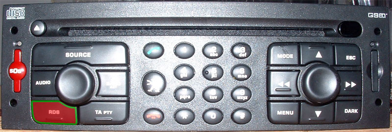

there is nothing in the cubby hole at all
it requests the nav disk to be in the cd slot in the dash
its got a round knob like a volume knob on each side surrounded by buttons and in the middle of them is a phone keypad and at the side of that is green phone and red phone and citroen logo
if you press the citroen logo come up on the screen with do you want to call citroen assist
if you go into menus has text messages etc in there
well strange system
the screen is the big one where clock normally is if that makes a difference
looked at loads of c5`s and never seem one like this

It's an RT3 navidrive system you have, your right the disc goes into the unit itself, the other type system has the seperate drive in the drivers side cubby. You use a ball point pen in the little hole above the SIM slot on the right hand side of the unit to eject the SIM holder.

wheeler
Posts: 7927
Joined: 21 Sep 2002, 19:07
x 1056
Unread post by wheeler »
Ok this could get confusing :)
Mk1 C5's all Have VAN/CAN multiplexing
Mk2 C5's & all C6's have CAN/CAN multiplexing
This is a mk1 VAN/CAN RT3 unit, It cant be interchanged with a mk 2, apart from its pysical size it wont talk electronically to a full CAN car anyway. RT4 is not available on VAN/CAN
This is what the RT3 & 4 units look like from a mk2 CAN/CAN car
The actual units of RT3's & RT4's look the same on CAN/CAN types its the operation, features & software thats different, these units cant be interchanged either.
The units comunicate with their screens via a fibre optic link.
Retrofitting an RT3 to a mk1 is deffo not feasible unless you had a complete donor car to swap bits off. Get a tomtom for £100 quid & a parrot handsfree for £60 & your sorted.
Messing about swapping SIM cards around out your phone & into the unit every time you go out in the car would be a bit of a pain if you ask me.
Cant really comment on the RT2 system as i've never actually seen one in a car or played about with one, only ever seen them in handbooks. they seem a bit stone age now anyway.
The Citroen,peugeot & fiat units are all the same apart from the manufacturer button has a different picture.

lol confusing, i have the top rt3 in mine, but have been told that there is a update cd up to sw version 6.63 think it was.
now having got hold of this disc any idea if it matters whicjh type of rt3 it is???

Version 6.xx is CAN/CAN RT3. It is not advisable to use the wrong software update in it. may damage the unit unless someone has tried & tested it ?

right ive gone for a different update after big of internet trawling came across eurovan2 forum and they have version 5.5d which is right version for mine which is a VAN software version lol 2005 update version
all updated and the difference is brill, point of interests added and loads more features
just been sent a new version lol 5.52a which is 2007 version so come weekend will try again :)
