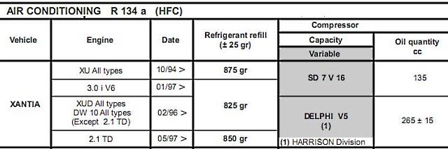

I copied this chart where air condition compressors are given for Xantia models.
Mine has SD7V16 which is SANDEN.
It seems that 2.1TD has DELPHI
and also note that there is a remark: XUD All Types (Except 2.1 TD) :?

Well, I know a DW10 HDi 110bhp system - complete - fits onto an XUD, as I have done it...
Differences I guess will be pully size, and pipe out let connections as I put above, other then that, condensers and evaporators are the same in all Xantia setups..

citroenxm wrote:Well, I know a DW10 HDi 110bhp system - complete - fits onto an XUD, as I have done it...
Paul
Which XUD was that though? the 9 or 11?

Unread post by Dommo »
In that case then that's what that table is saying. If you fitted a HDi compressor onto an XUD11 then the table would be lying :lol:
