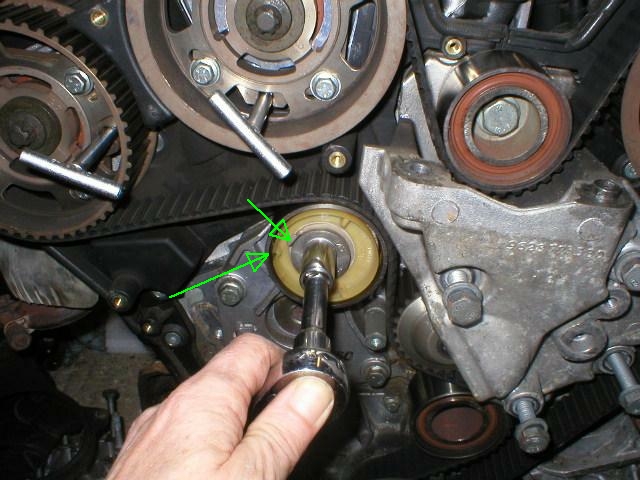

Not quite the same, you slacken the 13mm bolt in the middle & use an allen key to turn the tensioner till the pointer alings with the mark on the tensioner.
Posts: 55089
x 8391
Much like this on on a later V6 Dave...
The green arrows show the pointer and mark to be aligned...

That's great, many thanks wheeler and Jim.
The picture explains it well. Just wish I could have a similar view but I will be doing mine with the engine in car ......... :(
