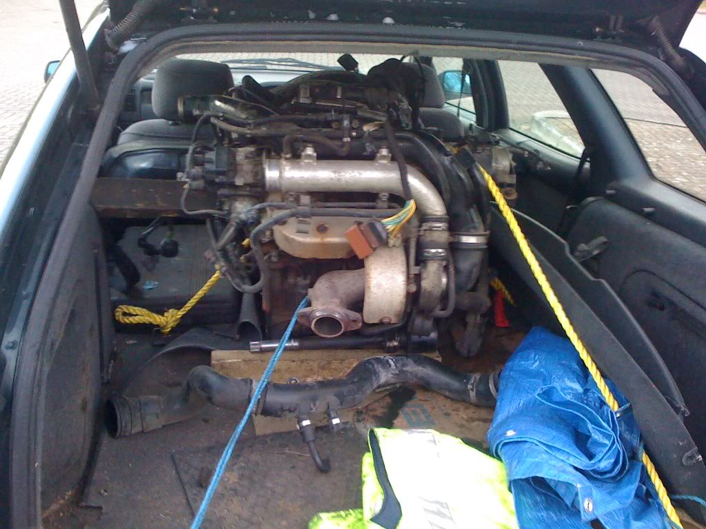

The only real worry is the top of the engine fouling the hinge area of the roof
when offering in the engine through the hatch on a hoist - you may need to
draw the bottom of the engine through from inside the car - care obviously
needed not to be squished!!
I had an extra boot carpet and loads of old footwell mats to support the engine
on a decent stout piece of ply so no damage would be directed onto the floor
or oil onto the trim and then plenty of ropes to stop it rolling and chocked
wood etc - had an old rimless tyre wedged between the engine and the folded
back seats as a kind of buffer too.
Andrew

Ive had two engines in the back of my xantia hatch at the same time, renault f7p 1.8 16v & c1j 1.4 turbo.
Fitted in fine with no dramas & with the suspension raising the back up to normal height was a total win.

Remember and be safe guys. In an accident what would consequences of insurance be if that load broke free and ended up on top of ya?

That nearly happened to a valued friend; hard braking made the engine slip forward despite being tethered - it squeezed him between the seat back and steering wheel. I'm always treading on eggshells with load like that; you need to drive like it a large truck and allow plenty of space while eyballing your "escape routes".
