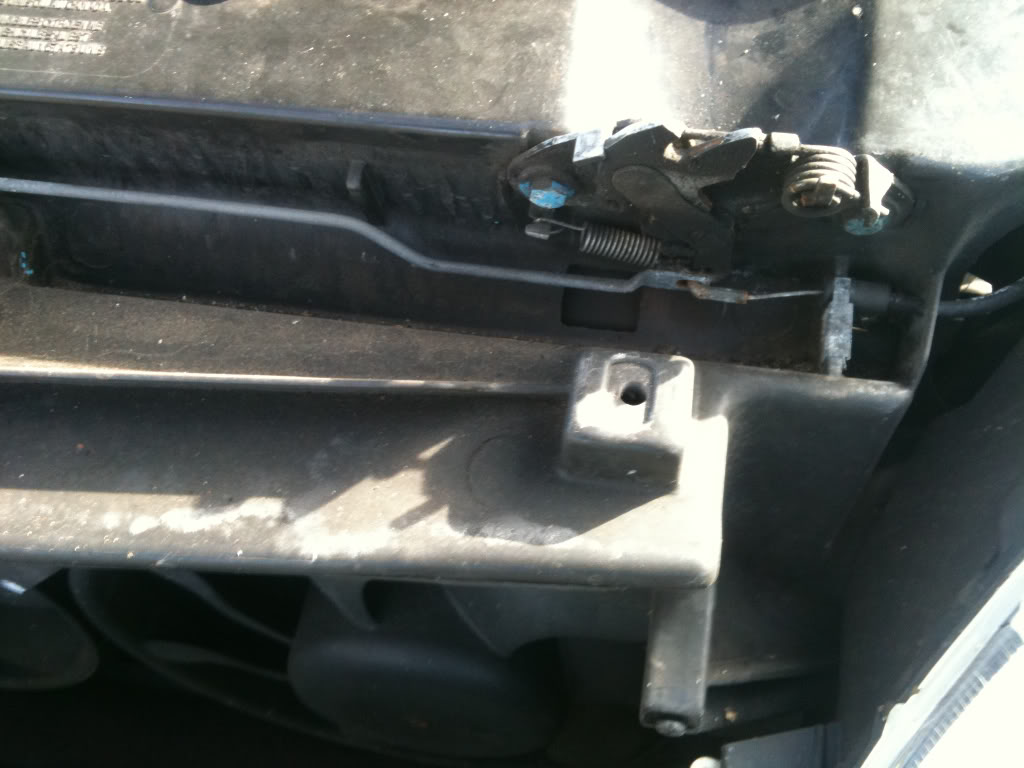

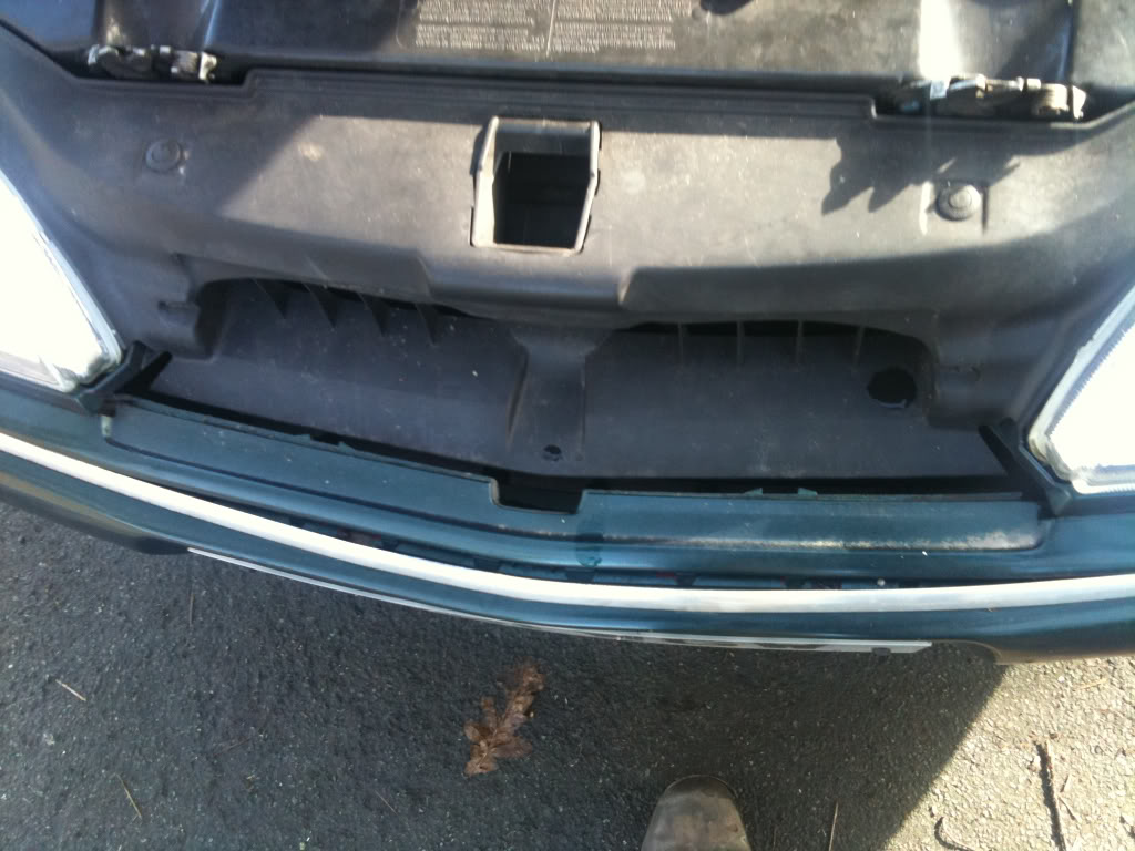

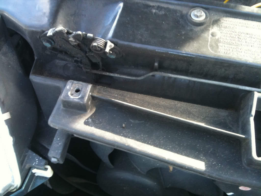

Right, it's the same design as the mk1 Xantia but the shield/shroud over the
nose above the fans is moulded quite tightly to the dropped line of the mk2
light and may be a pita to get under.
The rod that runs between the nearside catch and the offside is set into the
main headlight panel and may be difficult to actually get at through a gap on
the side of the bonnet.
Some pictures to help illustrate the layout:
Andrew
Andrew

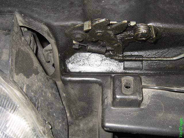

VertVega
- Posts: 1178
- Joined: 01 Nov 2008, 19:39
- x 13
Previous photos were really good that I thought there's no need to send more.Blackdog wrote:...they helped alot as far as where I was trying to locate a catch point...any more welcomed!!
If more are welcomed then here's one from me which is taken from a bit different angle and showing distance to headlamp.
As seen from the pic it's oil wet
You can also try some from the gap with a straw. In case its dry.
_______________________________
Edit: and counter part from bonnet... hope these will help.
