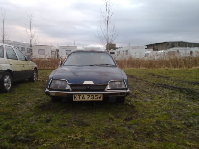

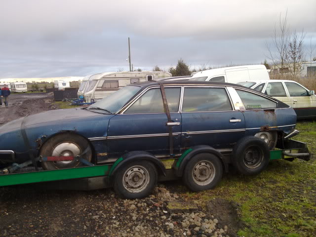

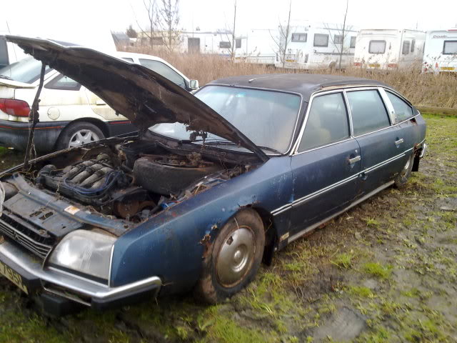

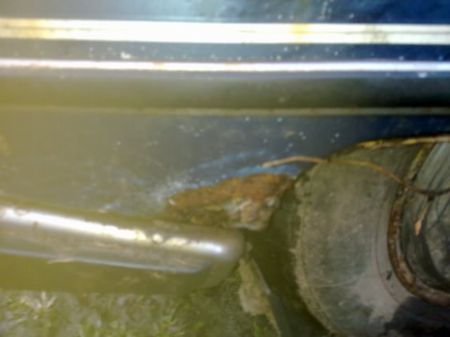

Right well the CX arrived today so I thought id start a new blog for it.

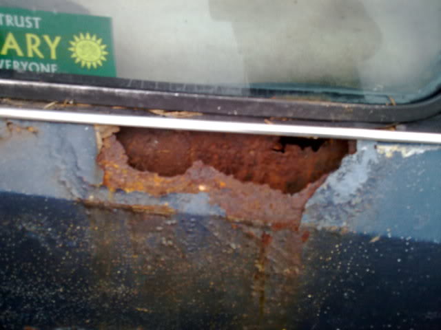

The rust is even worse than i though, but i sat inside it and WOW its gorgeous inside!
Im thinking of perhaps using roberts as a donor for this one as i do lke the low roof!
Have to wait and see untill they are both side by side, but when i say the rust is bad im not joking!
Some of the exterior trim has been replaced with wood.

Might be cheaper to get a donor car from Australia? You'll pay less than the cost of all that welding.

Good on yer Dave, It is going to be a very compelling blog indeed :D I must say the CX looks a treat even in a state of decay...

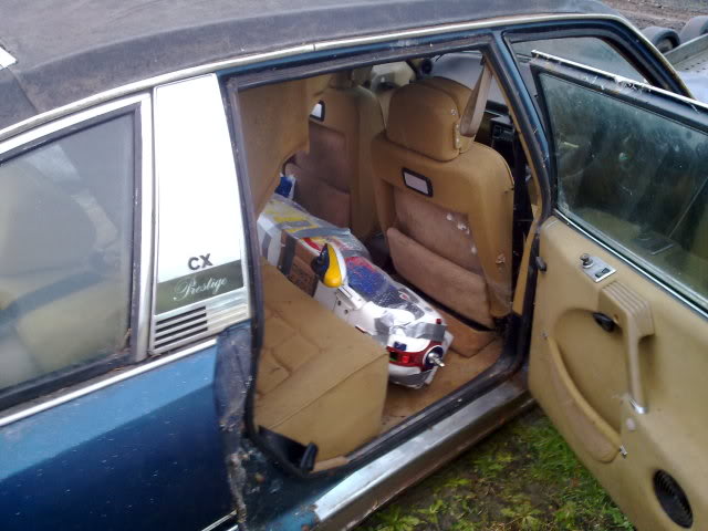

What on earth is that just behind the front seats in the tird photo?
As for the rust, well, to a restorer of British tin from the 60s and 70s, what you have there is a tad of surface rust, nothing more. Sort that before breakfast, no sweat.
Become a subscriber to Practical Classics. It's a bit of a comic in some ways but for body restoration it is tops. Every month there's an article or six on bodywork and different welding techniques.

Is that an R/C plane in the back?

Wow, what a challange! Looks like its been a very nice car in its day, no doubt you will have it looking just as good when your finished. Your certainly moving along quickly with these Citroens, it will be a DS next?

Wow! Even complete enough to have the footstools in the back
- yes the legroom is that long you need them! The only car you
can sit in the back and not touch the front seats with your foot.
You can get bodywork for these but it depends what's rotten apart
from the obvious visible rear wings and door bottoms.
How about the inner rear door jambs, base of the A pillars and roof
guttering along the drip rail and down into the rear screen?

Possibly, but even at this age I reckon they won't be toast but the pipes
must surely will be unless they've been done at some point in it's past life!!
The fact the car is complete rightdown to the chrome onm the sills/wheeltrims
and around the lights shows somebody cared for it even if they couldn't stop
the rot.
Does the car actually run as that would highlight the plight of the hydraulics?
It's likely a given the spheres will be shot as well as the exhaust and tyres.
If it doesn't start, look for the bumblebee buzzing of the fuel pump under the
offside rear crosstube. You may need to take out a big bankloan just to buy
fluide T so Robert's later 3-speeder may be mechanically more attractive.

And yes that is a r/c plane in the back, i acted as a bit of a courier service for it!
