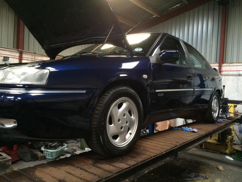

Well the Activa has had it's ram bush fitted tonight as well as it's pre MOT check over.
I found a hole in the join between the centre section and back box of the exhaust but I really don't want to put a new exhaust on it as it'll be getting a new one when the V6 goes in this summer. However, a sleeve to replace the old join and half a tub of gun gum has it sealed as best as it'll get. It's not pretty but should now class as a "Small exhaust gas leak"...
My Activa ram is still weeping as it's cold, over the summer when it gets used it stops leaking but always starts again over the summer. The MOT rules are daft... as long as the MOT tester can't see it drip he can't fail it. They are also not allowed to remove anything from a customers vehicle so my solution to that is to wrap a rag round it...
I also had two rear indicator bulbs that had gone white rather then orange so I've replaced both of those too. Fingers crossed for two passes in a row!

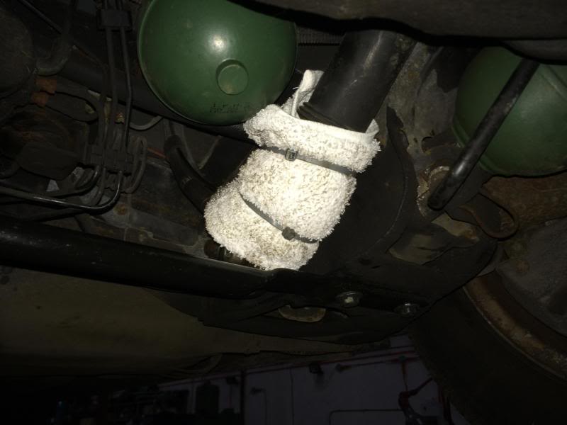

There's nothing they can do about itsuperloopy wrote:You got away with that towel on the rear ram, i dont believe it!
An MOT is a visual inspection of a vehicle. The handbook states that they are not allowed to remove anything from a vehicle that is undergoing an MOT test, it also states that they cannot fail something unless they can observe it drip whilst it's on the ramp!
End result... an MOT pass! Mine stops leaking after I've used it a bit, it's only when I bring it out of hibernation after sitting through winter when the seals are cold that it leaks.
David.

Haha, ballsy playing to the letter of the law, I love the towel trick.
Any "comments" from the tester about the towel or did you not get to speak to them directly.
Can't figure out why my subscription to this thread never emails me - I only stumble in here by accident every now and then and find much conversation has been and gone since my last visit due to lack of notification...

Simon, I've had a "You're at it" from an MOT tester when I did the same thing last year but I did actually take it back for him see it doesn't leak after a week or two.
This year I didn't even get to speak to the tester.

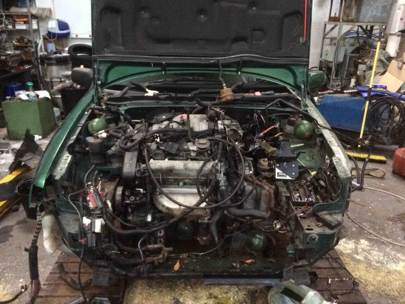

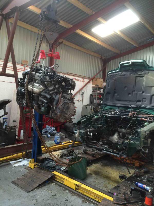

Well the engine is now out of the donor V6 and I've started to swap some of the parts over. The flywheel is now swapped to the manual version and I've started to strip the ancillaries down in preparation for doing the timing belt tomorrow evening.
