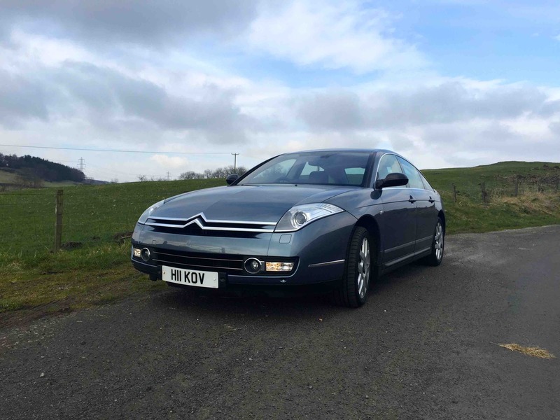

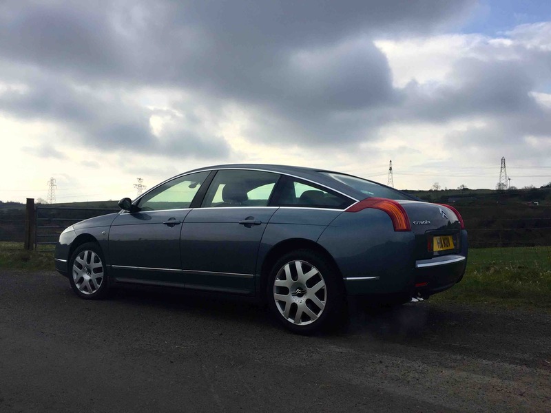

Well, here's a few more pictures taken as we went out for a run in it today :)
When I sold this car in December 2010 it had covered 30,600 miles according to the receipt that I gave Donnie when he collected it. Tonight it's sitting on 43,728. It had done less then 13,000 miles since I sold it :)
