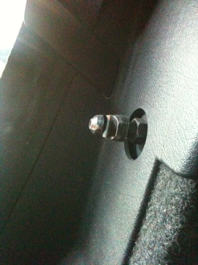

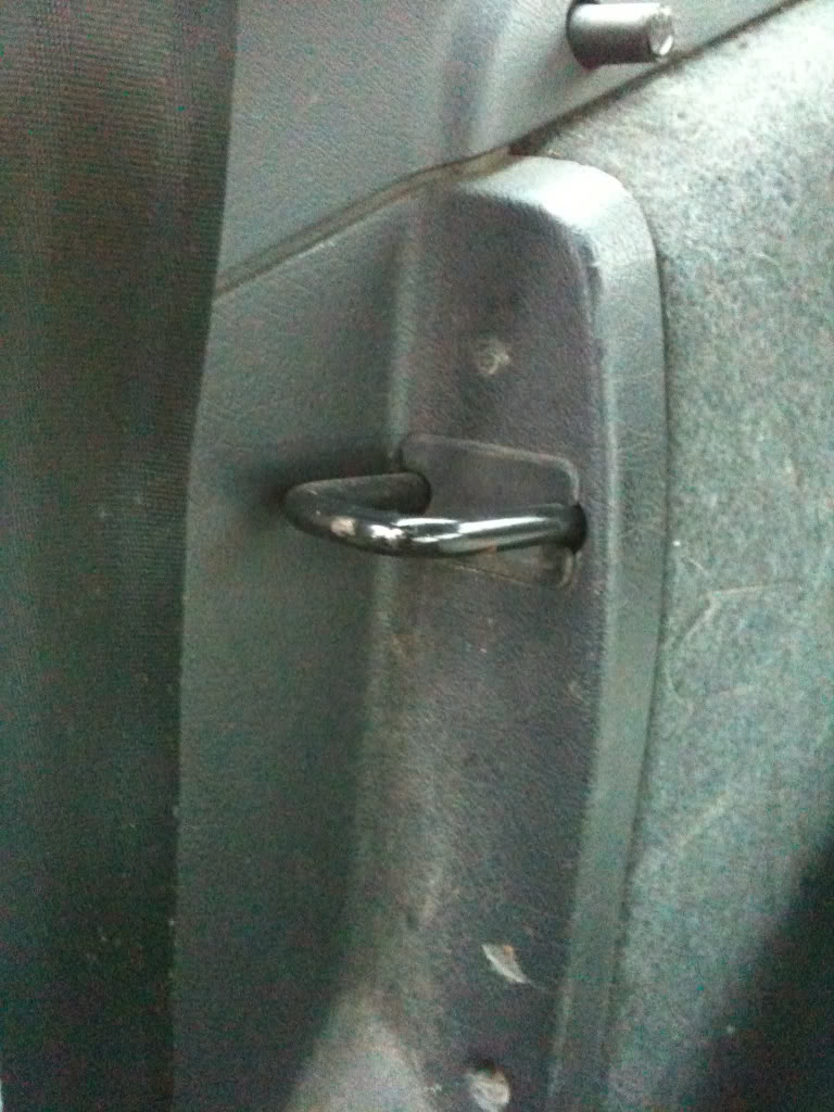

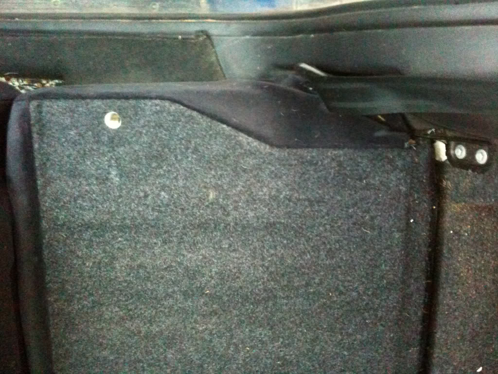

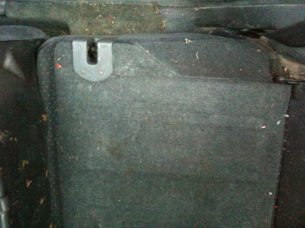

Key important fact here would be the lower rear seat squab mountings
for the seatbelts on the estate and the width of the mounting bar as
referenced by Jgra1 and the securing bracket for the backrests. I'm sure
John made this work for himself but I just can't see how a slot cut into
the saloon bodyshell with a grinder can help as the estate seat already
has a slot designed into it's backrest where it then mounts onto the looped
"buckle" on the rear wheelarch - totally different to the saloon with it's
pin arrangement:
estate
saloon
:oops: gawd, I need to get the vacuum cleaner fixed... :roll:
Andrew
