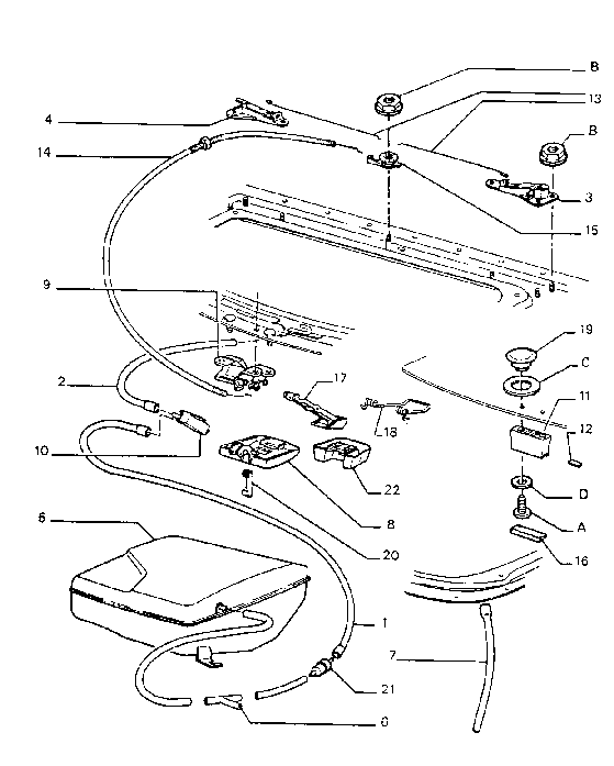

These are the only pictures I have of the pre-facelift sunroof (the sliding one)
First pic is the assembly itself:
Second pic is the vacuum system:
As you can see, the pictures are not very good quality I'm afraid, all I have though.
Andy.

The car's one owner from new until we bought it last spring, so it's definitely original. It's a 1.1 4spd "Style". Mmm. Pikey-spec-a-go-go.spider wrote:I did not know these type of sunroof's were fitted to pre-facelift models.
Yes, and no. I've seen that diagram in the HBoL, but this isn't vacuum (tfft). It's much simpler - the glass is just latched closed at the front. But the basics look similar.I have one but its face-lift and vacuum operated (the "seal" is vacuum operated) , is your similar ?
I'm in no doubt that I'm going to have to get... persuasive... on the screws, so I really want to be sure I can do it before fiddling!
