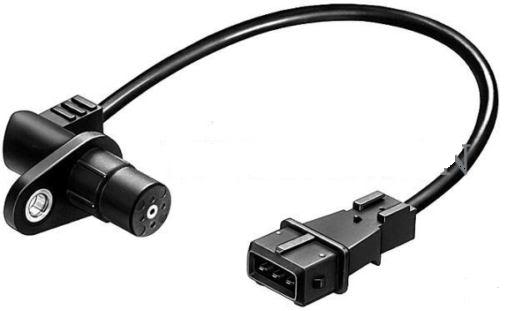

Problem solved it was the Crank Sensor mounted on the top of the gearbox.
Image[/img]
