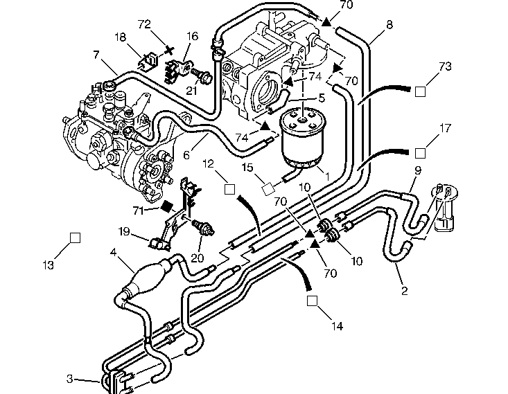

I think that originally a air bleed screw was fitted to where you found that plastic plug (similar to a brake bleed nipple)

Andy and Peter, thanks for replies. I'll try to block the hole and stem the leak. I don't think that it's threaded but will have a closer look in daylight. There's also a something in the middle of the hole which I can't see properly but may be the remains of a bleed valve.
The schematic of the fuel system is interesting. Do you know if the AX has a filter in the tank? I've seen this mentioned in other posts where air in fuel is a problem.

I removed the plug again and this time I put some gasket seal around it first and left that to set before I put a load of araldite around it. I also left it for a day to set before starting the engine. Started ok and it doesn't seem to be pulling any air in. This may be a temporary fix but at least I think I've found where the problem is. The plug is fitted at the back of the filter housing (roughly the position marked 70 in the above diagram).

The picture I have of the TUD5 is almost identical to the one I posted above, mainly the numbers identifying each item have changed, rather than much else.
