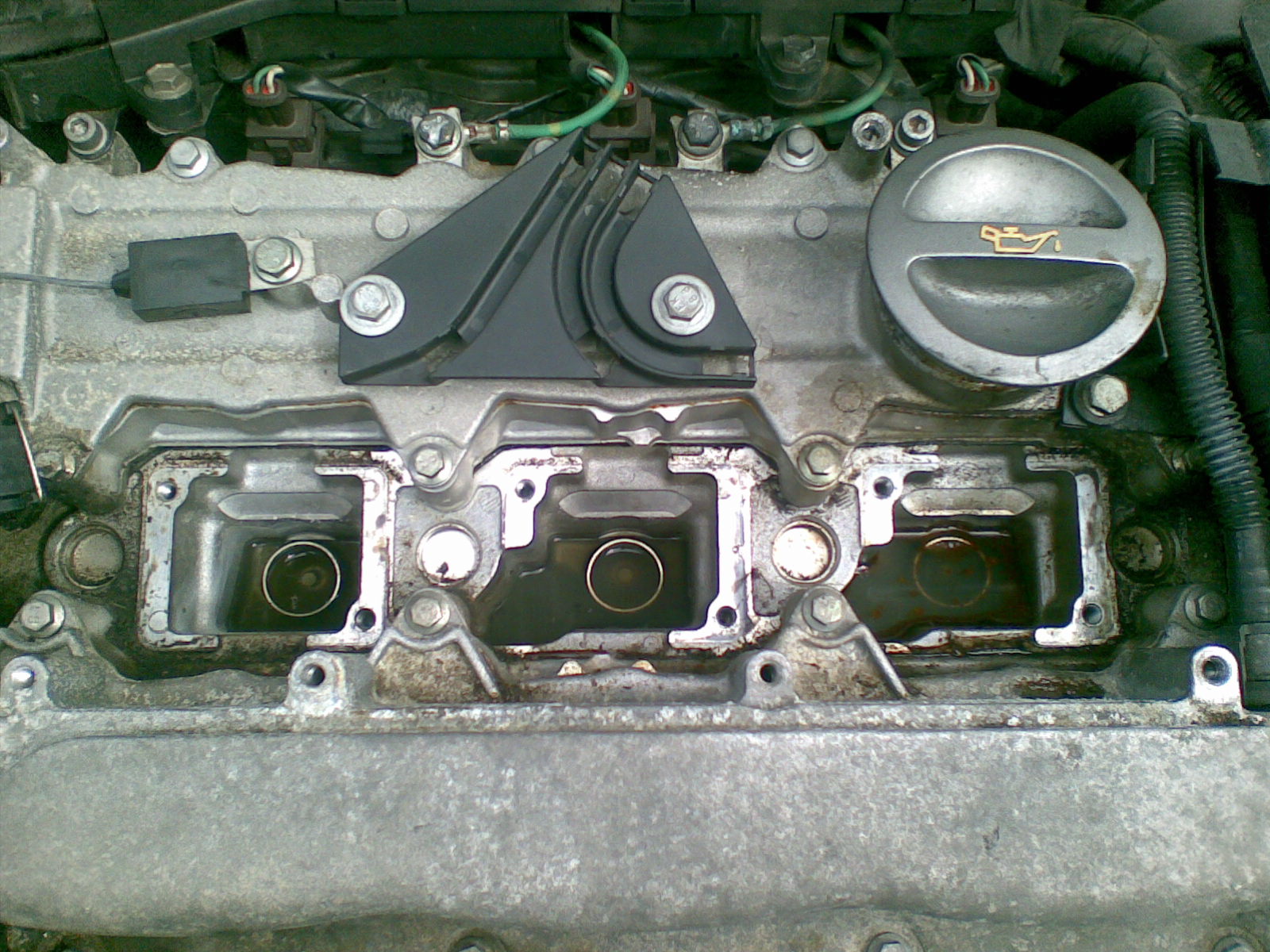

Sorry if they are a bit big, my browser (Opera) scales them down nicely if you hit the 9 key a few times!
After removing the engine cover...
Unclip the coil connector
undo the Allen screws holding in the coil pack
Disconnect the HT cables undo the HT cable tray and lift out of the way (this one, like many, has been previously broken by not having the rear bolt removed).
Lift out the coil pack
You can now see the front plugs
They should not look like this!!!
Release te knurled sleeve on the cruise control actuator
Remove the allen headed screws holding the cable tray
Remove the stabiliser bar (can't imagine any useful purpose for it!)
undo main air hose to avoid straining it later
best to unclip the MAP sensor cable (this photo is reversed c.f. most of the others, (the manifold is on the left and the bulkhead on the right)
remove this vacuum hose
Fuzzy shot showing manifold bolt on nearside lifting bracket remove this bolt.
The manifold bolt on the offside lifting bracket
Remove the bolts holding the manifold to the engine. ease the cable tray out of the way.
gently lift the manifold and prop up the offside end
undo the screw holding the cable tray running over the HT cover
Undo the HT cover
Carefully lift the HT cover, easing the cable tray out of the way
Now you can see the rear spark plugs!

Many Thanks V6. I had oil in one of the front wells at the filler cap. Sure it was just spillage.
