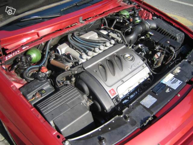

Admittedly an XM, not a Xantia, but the neatest es9j4 LPG installation I have seen:Sid_the_Squid wrote: Money wise LPG is a good money saver, although would be hard to find space to fit on a V6, eco wise I don't know if it is any 'better' as you'll actually be burning more fuel, just a different sort.
Actually the installion (perhaps complete with engine?) appears to be for sale
A modern LPG installation may actually be more efficient than petrol (especially the stuff available in NZ) because it has a higher octane rating, so the engine management can run more ignition advance without detecting knock.
