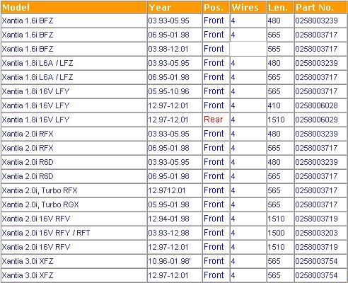

I also had to struggle with the emissions for the first time. Checked lambda sensor type to find out prices and etc.
(Unfortunately the catalytic converter which is more expensive than an O2 sensor, was the source of the problem
Mine had a Bosch lambda sensor with four wires (white, white, black, grey) with the type number 0 258 003 719.
I have found this data from 'Just Lambda' pages (www.lambdasensor.com) and confirmed from the sensor body numbers.
First needs a very good cleaning
As you can see in the list there are several options for 1.8 also.
You should know Engine type and production date to find the correct type of sensor.
