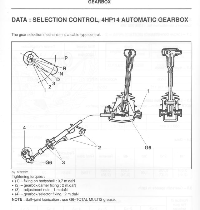

However, 2 days later, started ok but again very cold, and probably didnt give it enough time. Got it from 'p' mode to reverse when suddenly shift change lever went a bit slack. It has resistance when pulled down towards 2-1 but thats it. Does anyone have a schematic or photo's of the layout of the gear selector and how to get into it please? Maybe in my impatients could I have bent something in the assembly as I cannot now start it as wont go into 'p'mode.
Is there anyway to move gear selector temporarily from the engine end into 'p' so I can run engine and get susp-up to get underneath?

This is a diagram of the selector lever. It usefully shows the gear positions on the gearbox lever.
I also have all the instructions for adjusting the cable but basically, with both the 'box and lever in P, the balljoint on the cable should be in alignment with the ball on the gearbox selector lever. The nuts on the cable outer nearest the gearbox are adjusted to achieve this.
