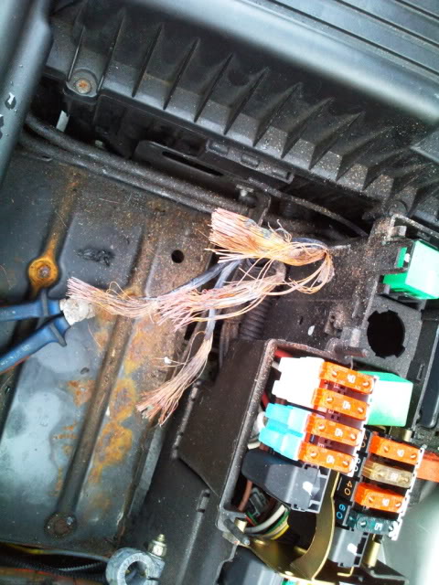

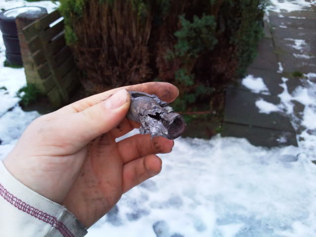

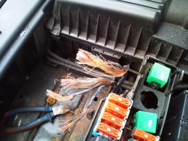

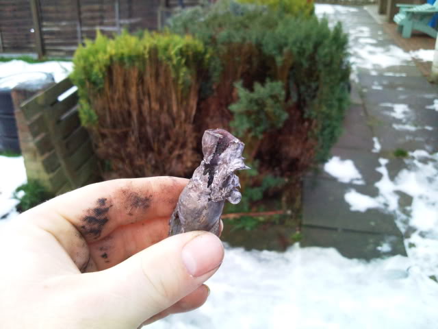

Small update,
Been out and removed all the sheilding from the cabling and there are four wires going to the +Ve on the battery
Four cables were mostly fused together heading down the cable about 6 inches. and a were bare in some parts. (unsure if this could have caused a short as they were only touching each other)
3 x thinner cables that run into that fuse box
1 x starter cable.
All are fried as you will see with the pictures.
I have temporarily cleaned them up and re wound the outer sheath.
plumbed the battery back in and temp clamped the cables back on.
started it no problem and switched everything electrical off.
introduced the rear demister and blower and two of the smaller cables started to get warm but deffo not hot.
I done a continuity test on these cables to the big fuses and i am sure one goes to fuse F and the other fuse B..... which are both 40 AMP fuses that are not popped.
heres some pictures.
and the battery clamp had melted off
Unfortunately my meter only goes to 10 amps
Cheers
stuart
1 x starter cable.
Cheers
stuart
